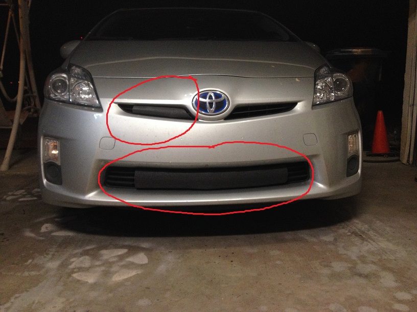

    Behind the diminutive upper grill is the hybrid system's inverter radiator. The AC condenser (it's radiator) is the much bigger piece, starting at the bottom of the inverter rad, and going all the way to the bottom. Behind both of them is the engine's radiator.
    The upper grill should be never blocked more than 50%, and only at low temps (if at all). Unblocking it does next to nothing for AC performance.
    I've circled in red the hybrid rad, the yellow highlight is the AC condenser:
