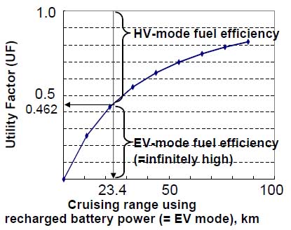

    It is not a real world number, but it is a paper math number defined by JP government using "Utility Factor".
    The math is shown at page-7 of following presentation, which link was introduced on my post.
    http://www.toyota.co.jp/en/tech/environment/conference09/pdf/phv_overview_en.pdf
    The 2010 Prius Plug-in is 23.4 km EV range -> 0.462 UF
    The 2010 Prius Plug-in HV mode FE is 30.6 km/L -> 53.8% (1 - 0.462) HV driving.
    The combined FE of the paper math is 30.6 km/L / 53.8% = 57 km/L (1.75L/100km or 134 mpg_US).
    Note: the FE numbers are based on the JP JC08 test cycle.

    Referring to the UF chart...
    The UF of Volt 40 miles (64 km) is approx 0.72, so the FE on the math will be 38 mpg / 0.28 = 136 mpg.
    Using 50 mpg Prius EPA number, the FE is 50 mpg / 0.538 = 93 mpg.
    The UF method does not reflect real world number, but it is used for comparison purpose among PHV vehicles.
