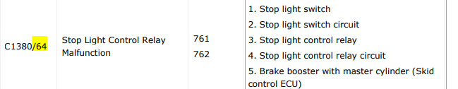

    I plugged a wire and the traction light blinked 6 and 4 times, here's what it should be ... As mentioned I replaced the brake (stop) light switch but didn't solve my issue because it was due to the STOP fuse. I actually put the original back one today to see if the light came on because I put a "china" part ... I may try to disconnect the 12v battery for a bit and see if it solves the issue . I doubt it though ....

    Well with those codes it can be your relay and or your skid control ECU and/or your brake booster and the brake boosters common to go on this model.

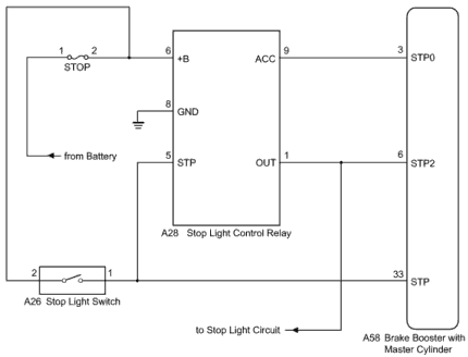

    The circuits of interest, involving the stop light switch, the "stop light control relay" (which is more of an interesting electronic thing, not an actual relay), and the brake ECU (which is part of the master cylinder/booster) looks like this:
    You can see how the stop light switch is an input to the 'relay' (at pin 5), but it's also an input to the ECU (pin 33, "STP"). Also, the output of the relay (pin 1) goes to the brake lights, but also to the ECU (pin 6, "STP2"). So the ECU knows when the relay is getting an input to turn on, and the ECU can also tell whether the relay did turn on. Big Brother is watching.
    Also, the ECU can light the brake lights for its own reasons (using its "STP0" output, pin 3, to pin 9 of the 'relay'). Again, it can see on STP2 whether that worked and the relay turned on.

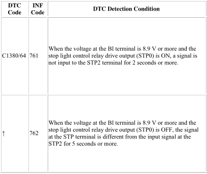

    With that background, you can look at what the codes tell you:
    As you can see, C1380-761 is given when the ECU tried to light the brake lights for its own reasons, but did not see the relay output confirmed on STP2. C1380-762 is given when the ECU is not trying to light the brake lights for its own reasons, but it notices its STP and STP2 inputs do not match: either the stop switch is ON but STP2 is OFF, or STP2 is ON for some reason when the stop switch (or at least the STP input) appears OFF.
    The blink method only gives you the basic code; only a scan tool can also get the 3-digit INF code. Because of your recent work on the switch, I'd probably assume you have 762 here, but if you could check with a scan tool then we'd know for sure.
