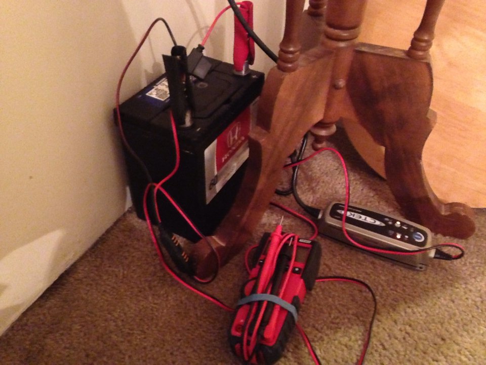

  19. Mendel Leisk
    61,501
    42,314
    I noticed (somewhere) a table of recommended charging voltages, for various ambient temps. Voltage values go up as ambient temp goes down. What this says to me, right or wrong, is that bringing a battery in the house, out of the cold, any charger will be more effective?
    (Out of our son's Civic, yesterday)
    #79 Mendel Leisk, Jan 31, 2015
