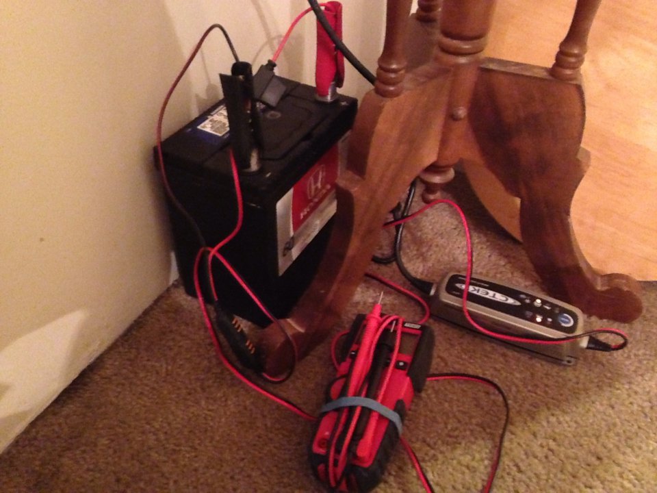

    I don't think that is a good idea because batteries give off fumes when being charged. If you need to bring your battery in the
    house to charge it its time to buy a new one!!

    Well I did the parasitic drain test, and like Mendel, after some time and everything finally goes to sleep I read 16mA. It would jump up to about 40mA every now and then but mostly held the 16mA.
    So I put my analog 2/10A charger back on to try to fully charge it. After about 3 hours the meter was down to zero amps and about 14.2V. I decided to just leave it on the charger a little longer and continue to check it.
    Mendel I checked my wife's Accord with a 3 year old Honda 100 month battery. It read 12.45V at about 40F.
    I would think the answer to your question is yes. The BatteryMinder that I ordered has a temperature sensor and says that it compensates for temperature by adjusting charger voltage.
