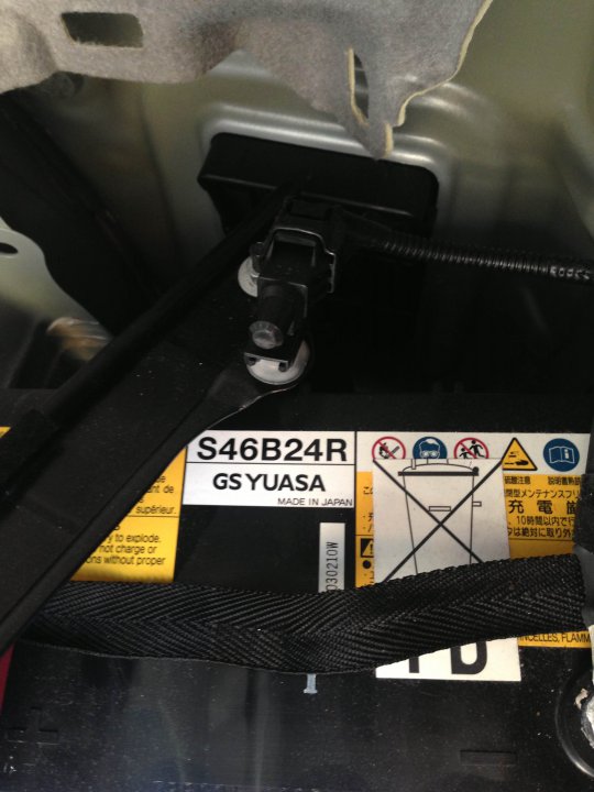

    12V Battery code is S46B24R. YUASA (see pix)

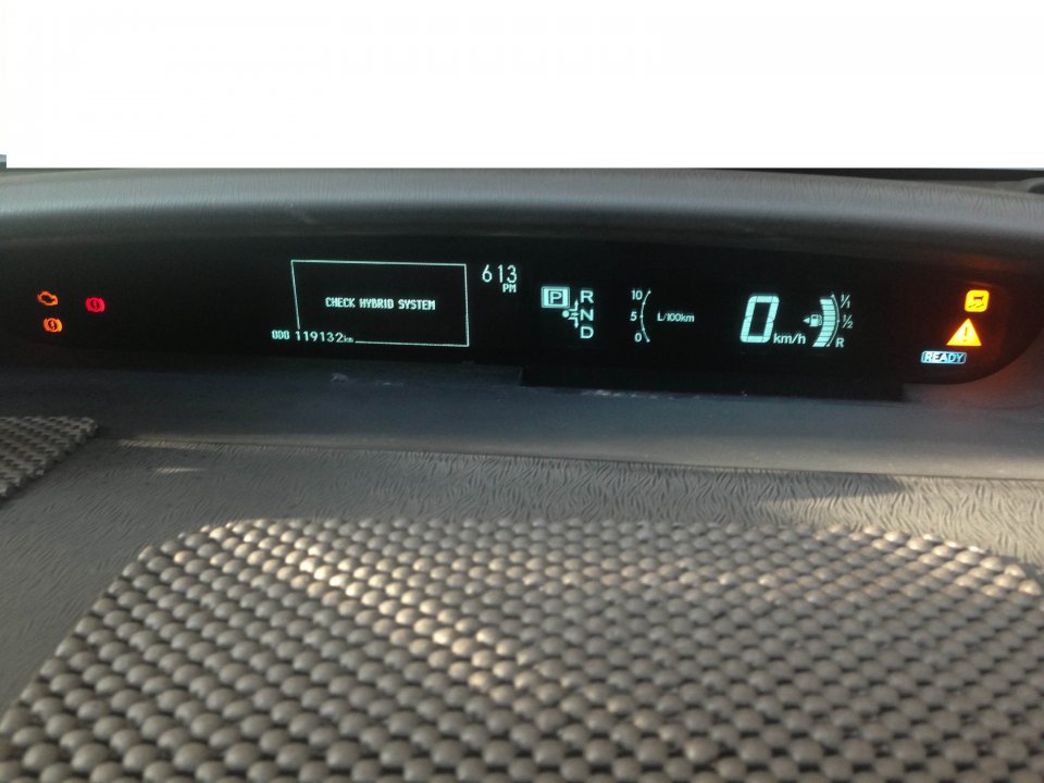

    What does this ' CHECK HYBRID SYSTEM' flash means? As per enclosure/pix. Car still runs but the gasoline engine is perpetually on . The flash came on last week .
    ODO reading is 119132km.
    Car is fully serviced and maintained according to schedule . Original batteries are still in used. Nothing has been changed except the tyres and the air conditioning refrigerant recharge.The car is 4.5 years old . Driven as a personal car with a daily commute of about 60-100km.
    Is the traction battery failing before the 12V battery ? .The toyota folks resetted the computer system without providing the error codes. Car operates as usual now but I don' t trust the dealer.
    Kindly advise . Thanks in advance.

    The battery model number is the S46B24R. The date code is the small label just above the lifting strap. 030210W.
    The date code format is DD/MM/YY so your date code is February 03, 2010. These batteries have an expected life of about 4 - 5 years.
    A low 12V battery will cause random messages such as you are seeing. Replacing the 12V battery will be the first recommendation when you first see random alarm lights and messages such as you are seeing. If you have a way to check the battery anything below about 12.5V after sitting overnight will indicate a low battery. A fully charged battery should read in the 12.8V range.
    After replacing the 12V battery if you continue to get these messages you will need to have the dealer, or someone with a Prius specific code reader, read the Diagnostic Trouble Codes and report back here for advice.

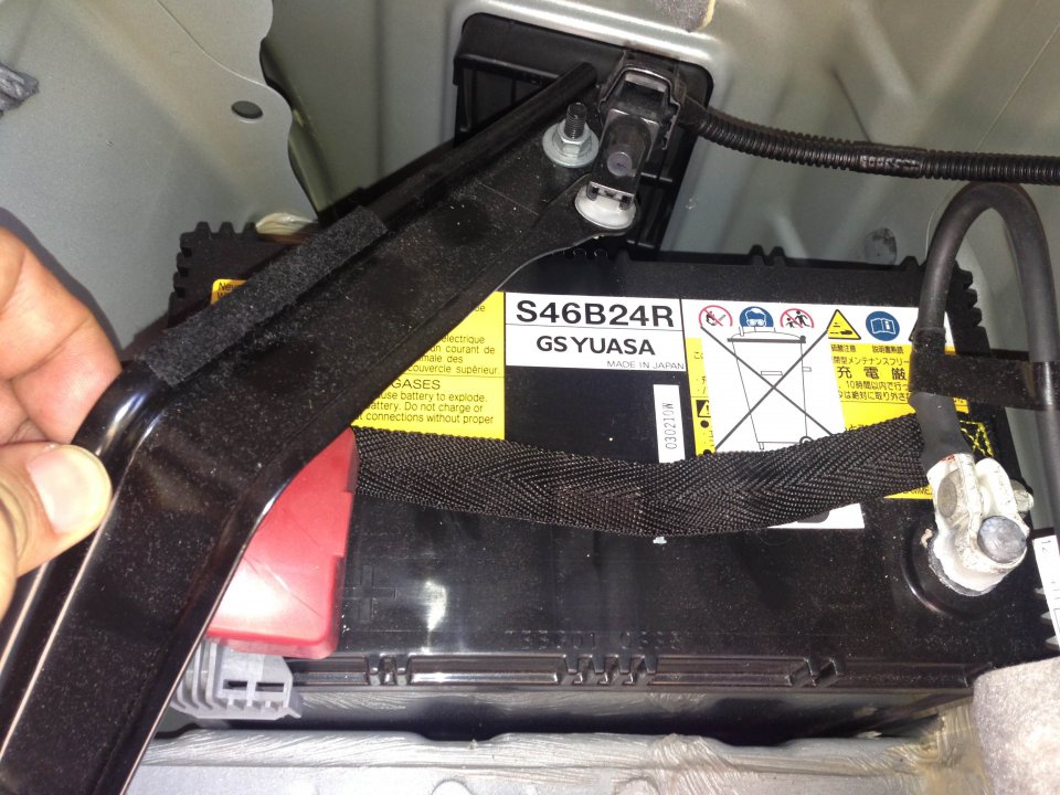

    Strong acid smell when I replaced the battery
    Checked the code on the 2012 that I just replaced
    200312W Anyone know what that means? No way that is a 2003 battery.

    The date code is DD/MM/YY so for yours is March 20, 2012.
