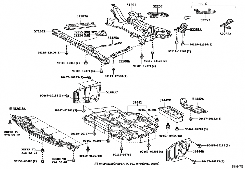

    Here is a drawing with part numbers from an online Toyota Parts site I use to research parts toyotamotorparts.com. I don't necessarily recommend them over any others, but I'm familiar with how their site works. I usually compare their prices with my local dealer and if the shipping costs will take it over my local costs I buy them locally. You plug you VIN in and it will give you an exact match. This file is generic 2010 Prius, but the under cover is probably good.

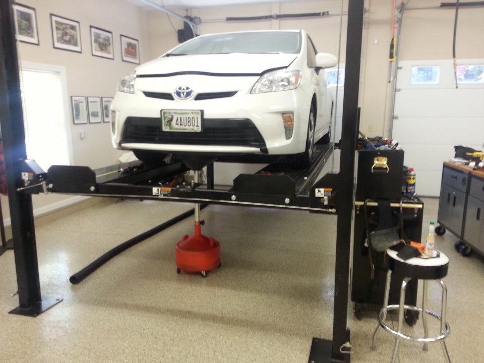

    Can someone please tell me the torque requirements for the drain and fill plug ?
    2010_Prius_I_White likes this.

    Both- 29 ft lb
  11. NutzAboutBolts

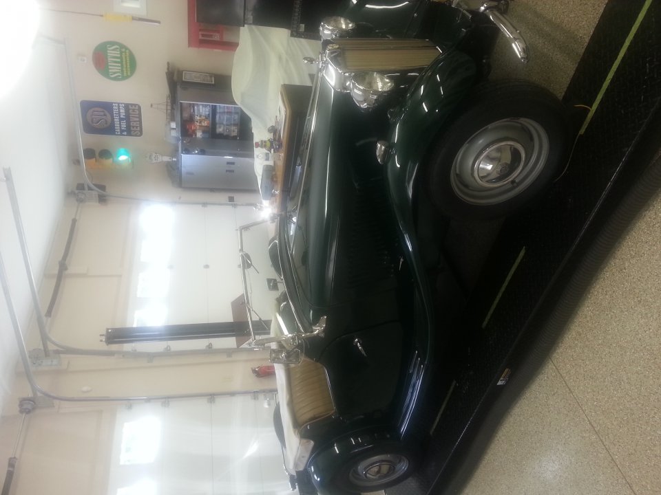

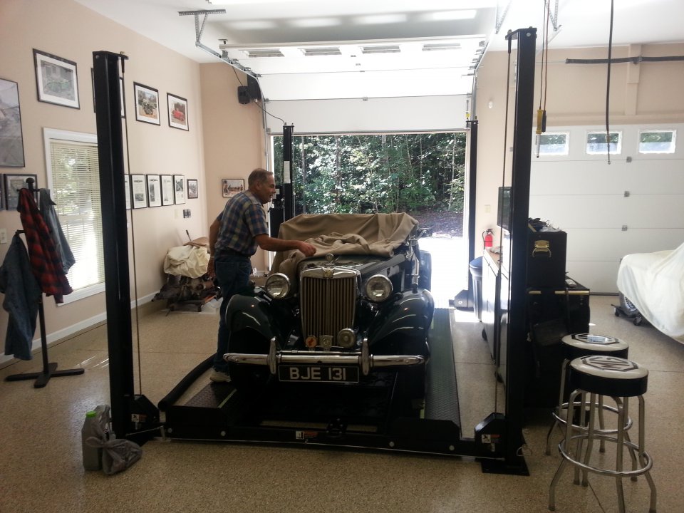

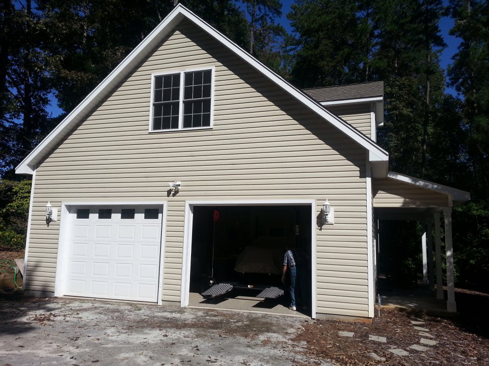

    I wish I got a lift like that! then all my work would be so easy :cry:
  12. edthefox5
    edthefox5 Senior Member
    Jul 25, 2007
    10,096
    4,833
    Clearwater, Florida
    Nice freakin' lift. Hope you have a hotter car than a Prius also!!!!
    If so SHOW ME!!!! PLEASE!!! lol...

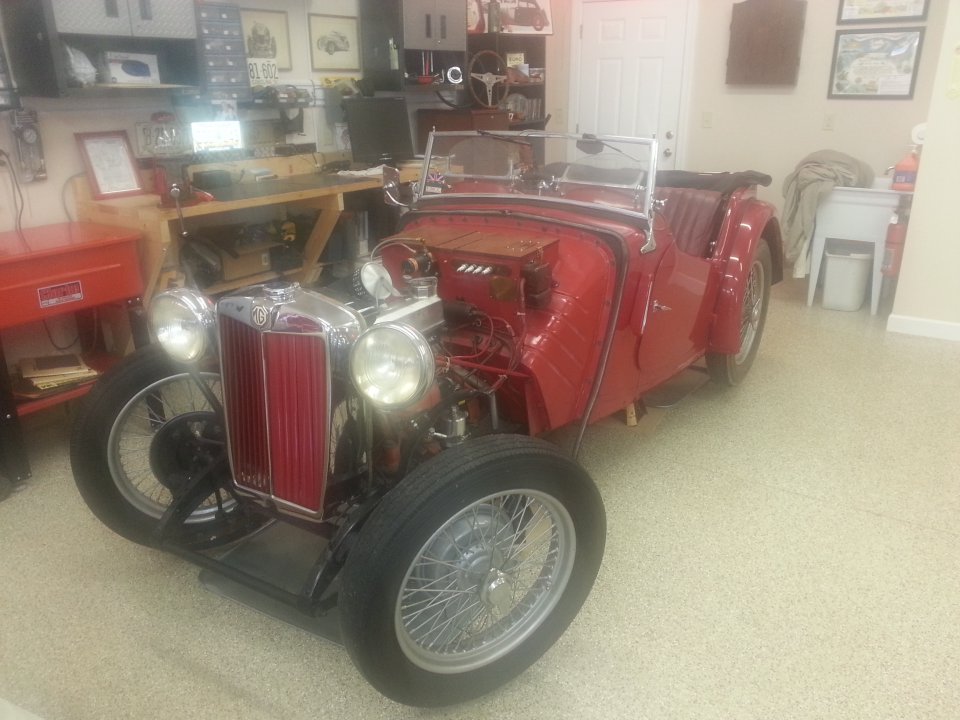

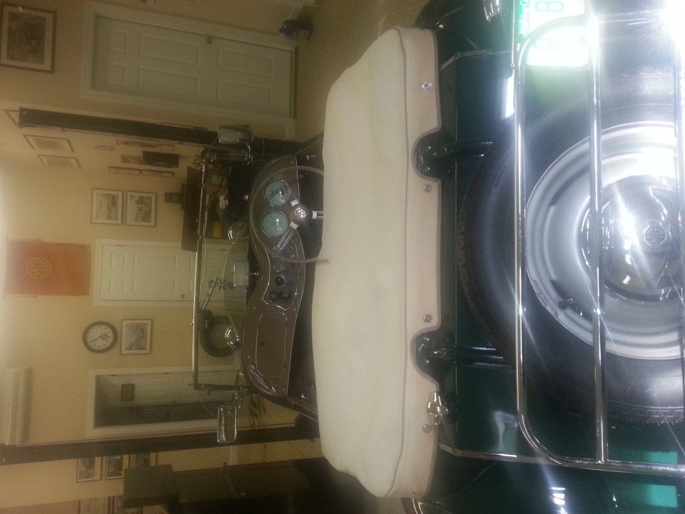

    Here's one. 1950 MG TD. Right hand drive.
    edthefox5 likes this.
  14. edthefox5
    Jul 25, 2007
    10,096
    4,833
    Clearwater, Florida
    Oh now your talking. That's awesome. What a beauty. So much fun to drive. Your garage is what dreams are made of. Is that a wooden frame car?
    Love the lift. Love the floor. What type epoxy on the floor please?
  15. slowrollin
    slowrollin Junior Member
    Jul 15, 2012
    Frozen Minnesota
    The red one is a 1937 MG TA . Still needing quite a bit more work. Im not sure exactly of the epoxy floor coating. It was done at the time of the garage build. 20130926_111423.jpg 20130926_105827.jpg 20130926_105653.jpg
