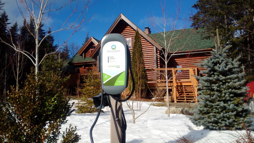

    I also recently bought a 2012 PIP (dealer demo) 28,000 km...advanced model from a dealer in Ontario this past November and then drove it (3000km) home to Newfoundland ( most easterly point in North America)
    Recently had a level 2 installed.. allows 2 to 3 charges some days.

    IMG_20150204_124647.jpg 40 amp level 2

    Ah, Sun Country. I was looking at the Costco plug-in one from Sun Country for $850. 40 A Level 2 but with a NEMA 14-50 plug. Is the Prius Plug-in your only EV/PHEV? because that charger is overkill for the PiP, but I guess it doesn't hurt to future proof for a couple of hundred bucks more.
    I believe the Sun Country units are rebranded Clipper Creek models, because they look exactly the same.
    ClipperCreek | EV Charging Stations | EVSE | Electric Vehicle Charging
    What did you do for the post the charger is mounted on? Does Newfoundland have rebates for the car and EV charger install? I can't get the EV charger install rebate. If I could I'd strongly consider installing it.
    Nice house by the way. It seems you have a long driveway too. :p

    Bought the technology package....when doing gardening last year, dug a trench for the 240 v cable and put a post in place..connection was easier when the time came for the level 2 charger.
    Future proofing is the plan... when the time comes to trade my wife's 2009 prius the plan is to pick up my an full EV as the other car
