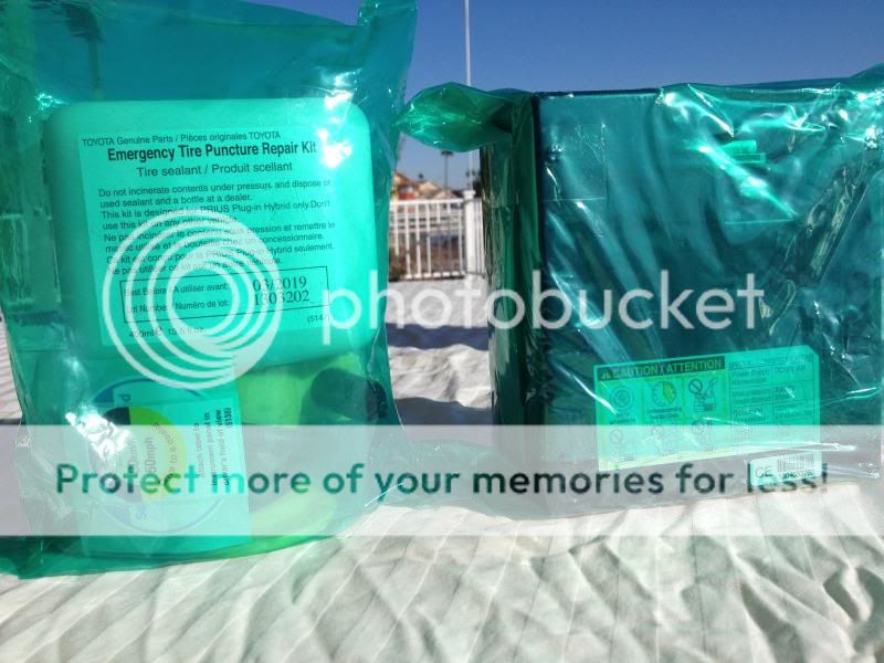

    Hi Trih,
    If you are interested, I have the brand new factory compressor and factory sealant that would be willing to sell. It is from my 2013 PIP I bought Oct 30, 2013 (Sept mfgr date). As I am sure you have found, you cannot buy just the sealant from Toyota. It is only sold as a kit (compressor and sealant). Private message me if you are interested or want more info.
    [​IMG][/URL][/IMG][​IMG]
  5. 3PriusMike
    Jun 21, 2009
    3,101
    2,421
    Silicon Valley
    That is a different sealant kit than came in my US PIP.
