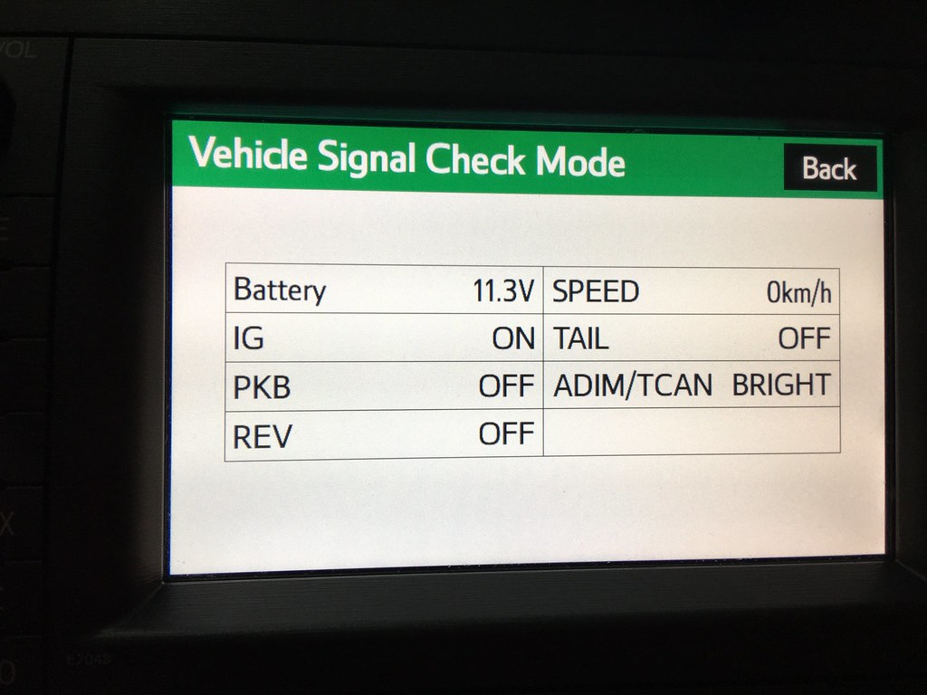

    Was told unlike Gen 2, Gen 3 does not have this test mode!
    I see several Multimeter Battery Tester models on Amazon, but which one to buy?.
    Thanks!

    I think checking battery should be simple:
    1. Push power button once.
    2. Turn lights.
    3. Measure by voltmeter (access is simple)
    If 12.1-12.X V then it's ok. Anything wrong?
