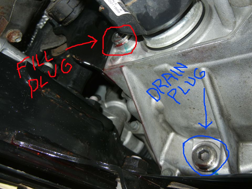

    Was doing my tranaxle fluid change and stupidly stripped the bolt for the refill plug. The angle was tight and I thought I could remove it without an extender. Luckly.... I was still able to get it out but would like to replace to prevent future problems. Does anyone know the specific part number from Toyota for this plug?!
    Heres's a photo for reference. Thank y
  9. Mendel Leisk
    61,450
    42,289
    Dealership parts department would know.
