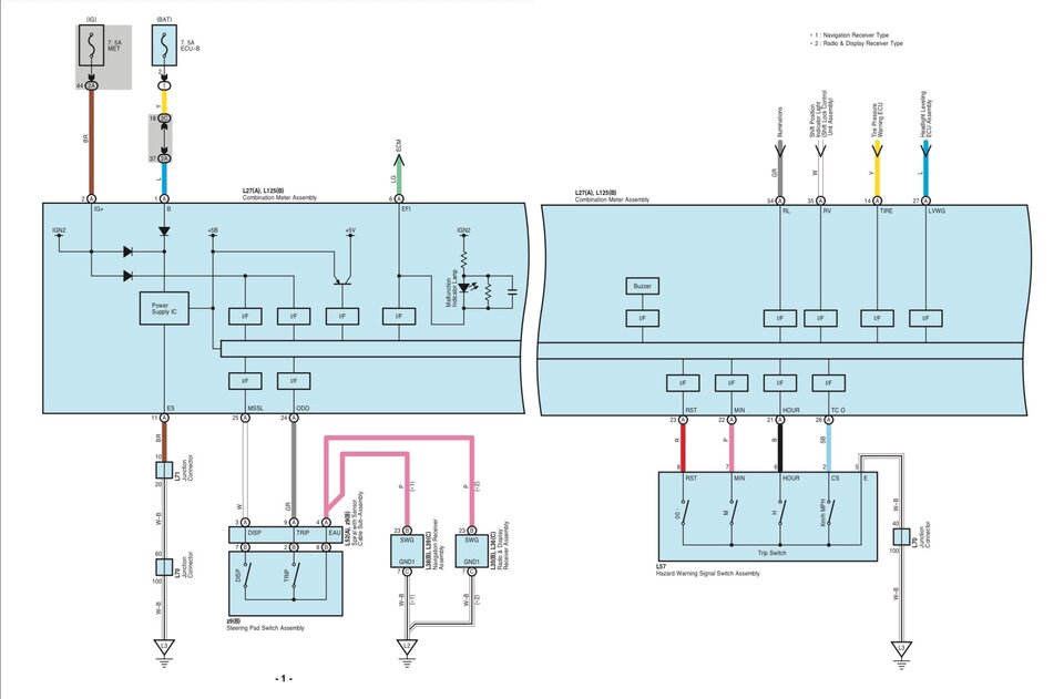

    here is the pcb

    These are the only capacitors on the board.

    I have never heard of a gen3 combo board fail but they do get dimmer and I have watched this v forum since the first v's were delivered in fall 2011.
    Check if the combination meter ecu is online when it appears out using Techstream or other hybrid capable scanner.
    Very likely power or ground related, not capacitor. Bad connection at connector, junction or fuse box. I would use Deoxid on the connectors.
    If that didn't work I would get a salvage unit and try it. Not sure if a replacement board needs a scanner config.
