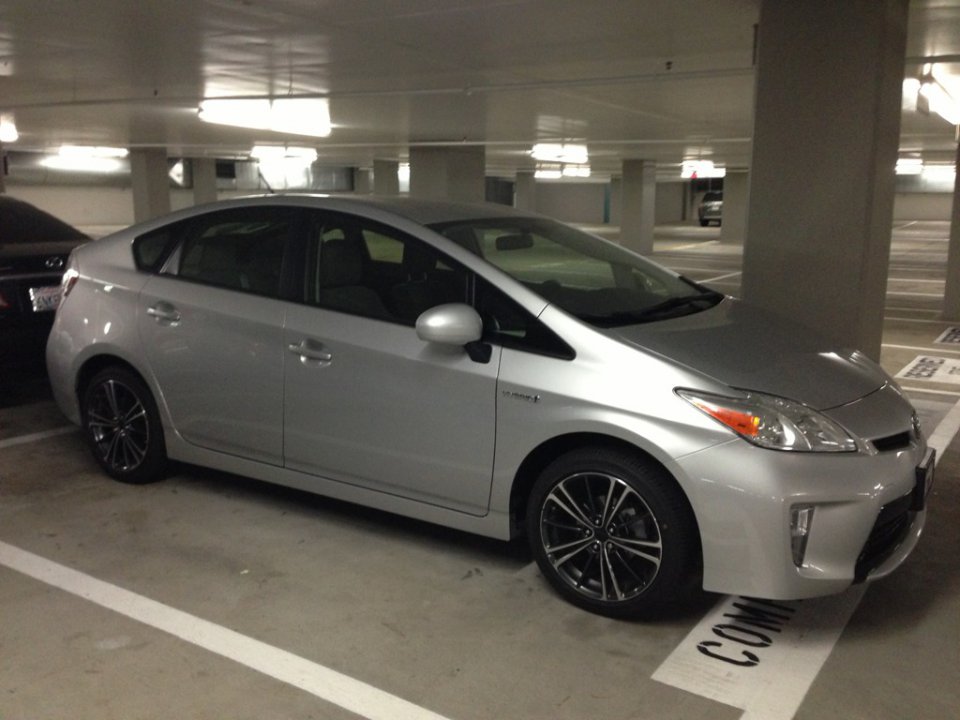

    Hey Firemechanic. I just got the same set of wheels and plan to buy the same spacers you did. How are they so far? Were you surprised that they came in @ 3.5mm rather than just 3mm? Also, did you request for the new hub ring to be 10mm or is that the length they would have cut it to anyway? How is the fit of the new hubs to the car and to the wheel? Sorry for all the questions. I'm very interested to see how the overall experience worked out. Thanks in advance!

    The spacers so far have been great. I havent lost torque on the lug nuts yet so everything is staying tight. I already have 4K miles on them, thanks to a drive to San Diego over spring break. The spacers came in at 3.5mm thick but thats just fine. When I requested the hat height to be 10mm the representative on the other line said that they would have made them around that height anyway. I always like to be sure so I specified all measurements. If you need specifics, contact info or maybe the job ticket # let me know.

    With same custom spacers as firemech
