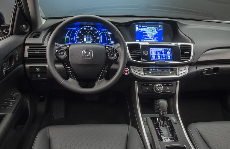

    The instrument cluster does look cool. I hope it has useful information and not just sparkles and rainbow. The rear seats don't fold right? But it's a decent size trunk. If priced right, it can have a serious impact on the Camry, especially for those that prefer a sportier drive. Not many people know of or remember the 1G Accord Hybrid so I don't think that'll hurt them too bad.
  11. bisco
    113,705
    51,741
    the steering wheel looks slightly off center...
