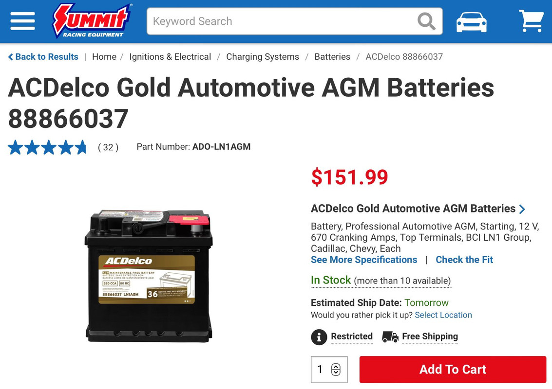

    I did some researching over the weekend and made a spreadsheet with some basic information. (Maybe a little overkill) Hopefully it's beneficial to anyone else who needs to replace their battery too.
    I'm having problems uploading a pdf or an image, so I've linked an image of the pdf here: temp Imageq MOas T — Postimages
    If I can figure out how to upload a pdf, I'll come back and add it here.
    Bottom line: it looks like I can get an AC Delco absorbed glass mat (AGM) battery in the right size for less than I can get a traditional flooded battery. Great deal from some online sellers. I'll likely go with Summit Racing at $152+tax, free shipping, no core. Most other retailers charge $250+ for a comparable battery. The AGM will be an upgrade which should last longer and give me more radio time.
    AC Delco is a GM company, and they don't list any applications for other car manufacturers, even though some of their applications use the same exact size. I've since learned that BCI Group 140R, DIN H4, and EN LN1 are all the same batteries. Same dimensions, same terminal locations and polarity.
    Battery Group Sizes and Cross Reference Chart with pictures | BCI, EN, DIN Codes

    Just following up to add a fixed link to what I found was the best deal. (The link in my pdf included a session id, which breaks it for other users.)
    LN1 AGM
    ACDelco 88866037 ACDelco Gold Automotive AGM Batteries | Summit Racing
    This is both the best battery (because it's an AGM) and the cheapest I found.
    Landed on my doorstep for $166 including CA tax, free shipping, perfectly packaged and handled. No core charge. Took about 10 minutes to install and is working perfectly.
