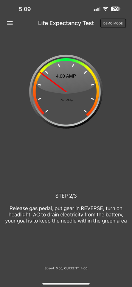

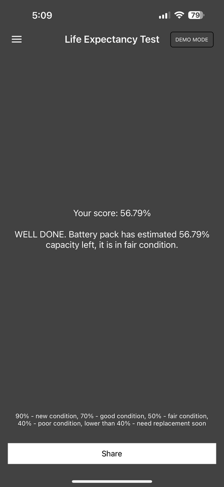

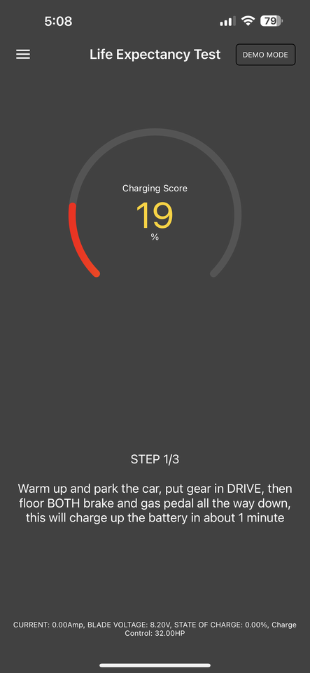

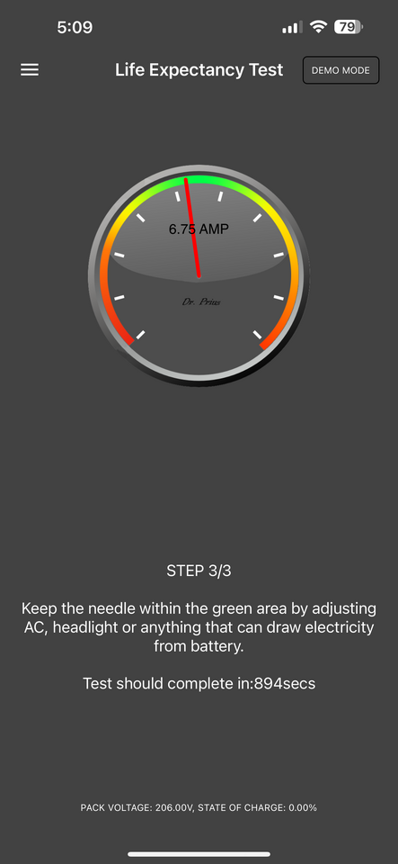

    Some believe the paid Dr Prius phone app has an accurate hv battery capacity test. I find it is too variable on the same car but it's about the easiest indicator. You do some forced high rpm charging in D with the brake on and then drain it according to instructions in an effort to test capacity.
    See Dr Prius demo pics below
