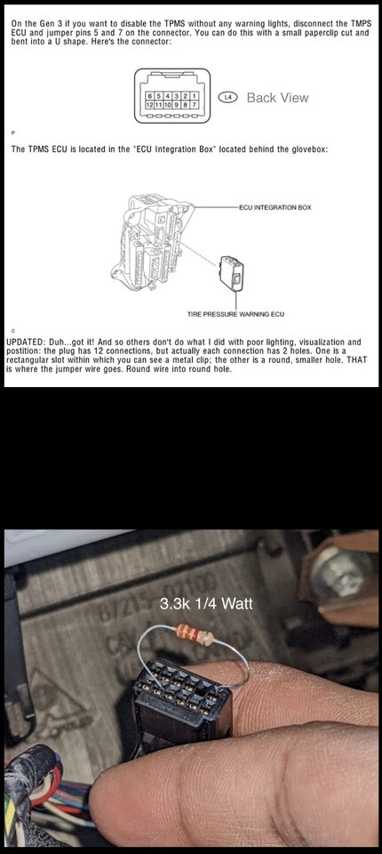

    Disable tpms ecu with jumper
    (gen3 but gen4 may be the same)

    been driving for 1 whole day already, no tpms light on. how do I know if they disabled the tpms system? I thought tpms system cant be disabled.
  4. rjparker
    rjparker Tu Humilde Sirviente
    Jun 6, 2008
    11,108
    6,970
    Texas Hill Country
    See previous post's attachment

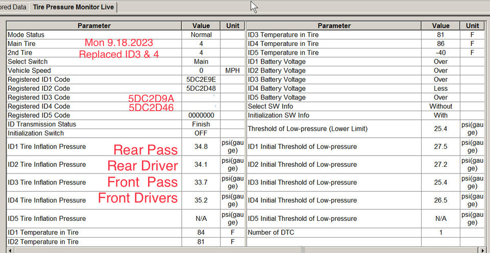

    This one has a coupon reducing the set to $34. They have factory set ids which can be written to the tpms ecu with Techstream.
    But first you need to figure out your current situation. It is either tpms disabled or you have tpms sensors. I would check the tpms ecu with Techstream.

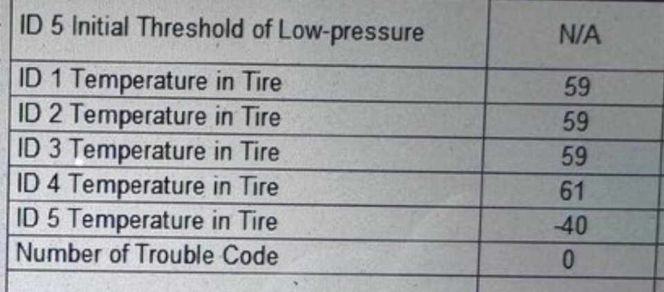

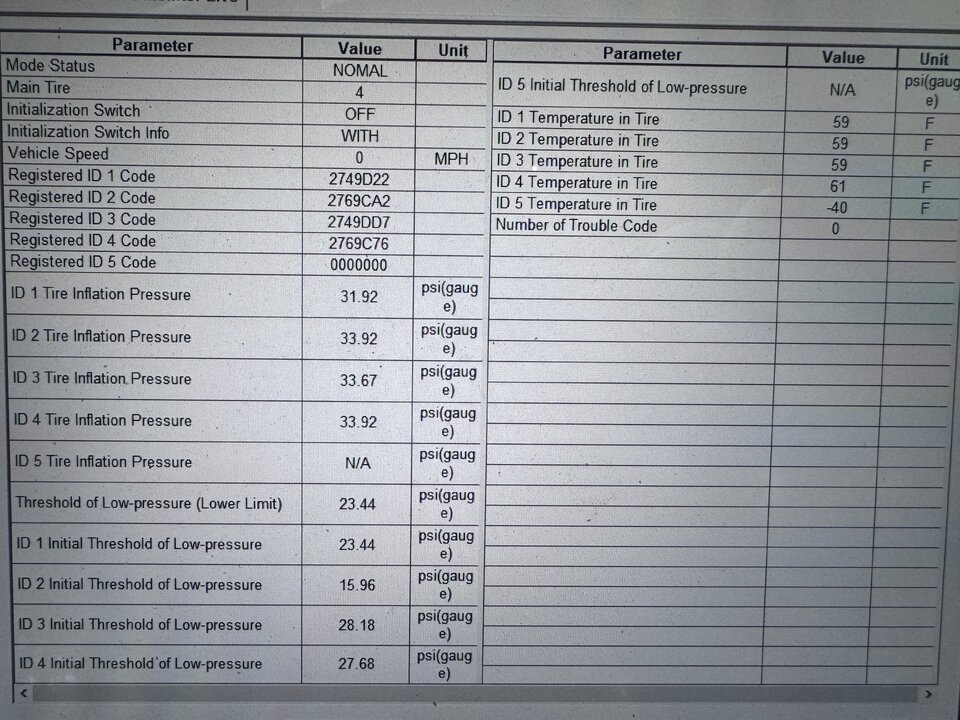

    It would certainly be worth checking to see what is in the data.

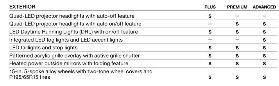

    That looks like a steel rim; I though that ALL Primes came with aluminum rims and the chinchy plastic wheel covers. You must've bought that car used.
