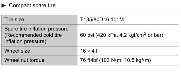

    I can’t find a good link to buy a spare tire for a 2021 Prius prime xle. Don’t want to carry a full tire I as use my trunk a lot . Anyone have good suggestions or links on what spare tire fits or link where to buy??! Thanks

    i just carry a full size spare from a junkyard. It was a lot cheaper and you can go full speed as long as you want.
    Just my 2-cents
