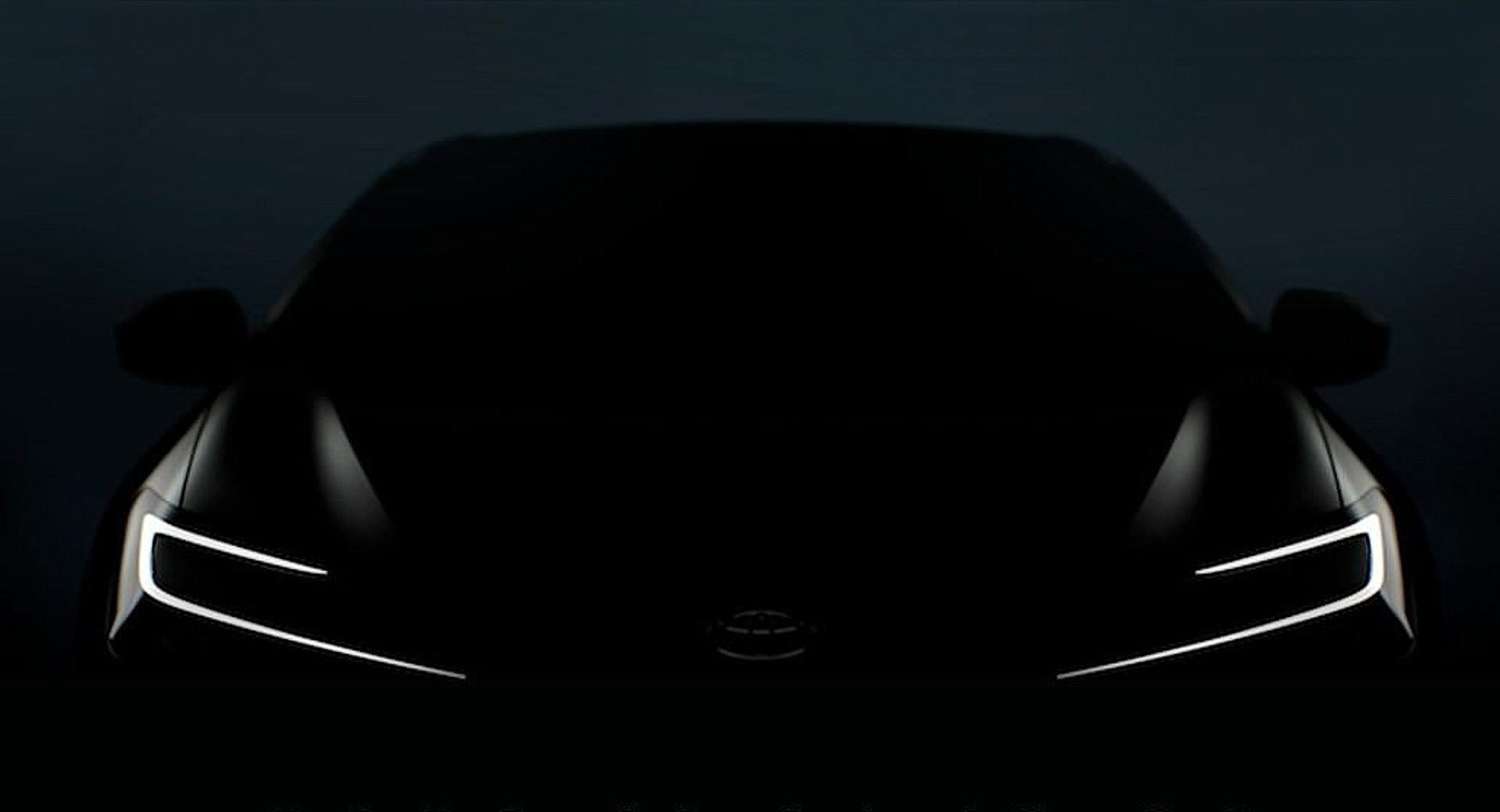

    I believe it is supposed to look like this when DRL mode is on. But my Prius has the low beam on.

    Maybe I am wrong. This line of lights could be the real DRL for higher trim.

    From my understanding the LE’s “hook light” only turns on at night when you turn all the lights on. The daytime running light is the low beam plus that little horizontal light bar by it.
    Obviously I could be wrong and not many current LE owners are here. Could you pls take photos of the headlights in different modes?

    You are right. I figured out to only turn on the LE's "hook light" without the low beam. But all screens in the car dim and Android Auto goes to dark mode.
    The horizontal light only acts as turn signal I believe.

    The "hook" light is not the DRL.
    The hook light is a marker light on the LE and a combination marker light and turn signal on the higher trims. Note that on the LE, the bottom strip light, instead of the hook light, is a combination marking light and turn signal, and on the higher trims, the bottom strip light is located higher and it is only a marker light.
    The DRL is the low beam but run at a low intensity. A marker light is not qualified as a DRL.
    As others mentioned, the audio issue must be with your phone.
