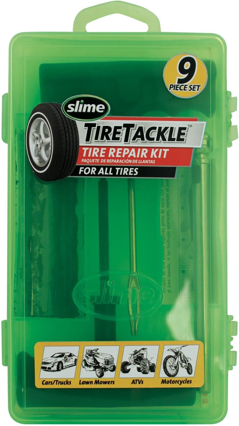

    85
    9 bucks. All I needed in the past 20 years. You can thank me later.

    Needs a portable air pump to complete the kit.
    The goo pump that came with the car very likely can't be used as an air compressor alone.
    McCarthy and Mendel Leisk like this.

    Vast majority of tire issues come from nails and screws. They almost always cause a slow(er) leak. When I'm at home, I jack the vehicle, find the nail / screw, pull / screw it out, clean the hole with the tool, use one of those rubber patch strips with some glue, and inflate with the compressor in my garage.
    When I face a leak on the road, there is usually enough time to find a gas station with air. The tire monitoring system gives enough room. Instead of jacking the vehicle I just rolled it to a point where I can access the nail / screw. Same process, takes me 3 minutes.
    I live in a part of Florida with a huge influx of people moving in from up North. We have new residential communities being build EVERYWHERE. That ongoing construction comes with a ton of... nails and screws laying on the roads. I catch one every few months.
    Been using those rubber strip patches for a long time. Never replaced a tire after patching, I just keep driving until the thread is toast. Never had a blowout.
