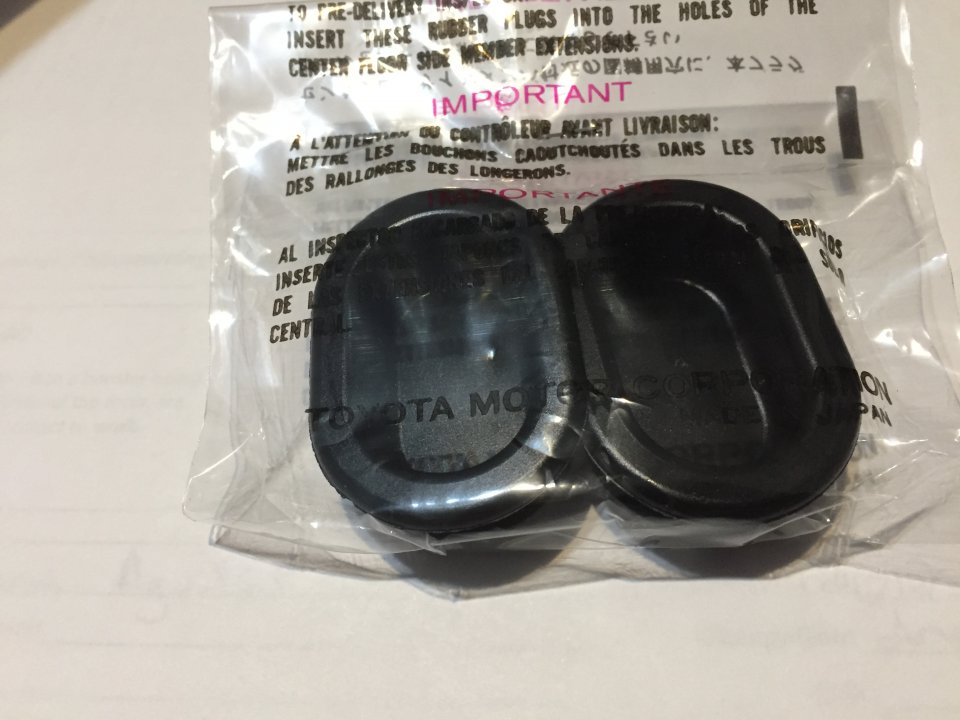

    I've seen it mentioned a couple of times that the dealership is supposed to install a cover on the holes used to tether the car during shipping.
    Does anyone have pics of those holes on the G5? Finally had to retire my '05 and picked up my new Limited last night. I saw this hole referenced before I got the car and when I was cleaning out the glove box of the '05 found the plugs. It explains why I could hear rushing water when I drove the car after a heavy Florida rain. Within the first year of getting it, I complained of the sound and that it smelled musty in the car after a rain. They tested and said they couldn't find a leak. I now know where the water was getting in...
    I asked the salesperson and of course he had no clue what I was talking about. I went out today and looked under the car - I don't see any holes near the rear jack spot. I can see the holes on my '05, so I have a good idea where to look. It seems like there's a cover on the undercarriage - I only see plastic up to the cat/muffler. There are plastic caps on several holes, especially near the outside edge of the car. But no rubber plugs at all.
    Maybe they dont use an undercarriage anchor anymore? I read that some cars are tethered on the bumper where a tow hook would go. Or maybe the Limited has a cover underneath and there's an empty hole hidden behind it?

    It's hard to take a photo without jacking the car up - but I've attached what I could get.

    I don't think they'd be covered up, need to be exposed during shipping.
    Those points tend to heavily reinforced plate, possible contenders for jack stand placement. If the 5th gen is similar to previous, the proscribed scissor jack placement positions are very flimsy, like a knife edge.

    @Hammersmith
    Thanks for the diagram!
    I'll get back under there and see if I can locate them. There weren't any in the glove box - so if they're missing I don't know how I'll get replacements.

    The hole plug diagram (thanks to @Hammersmith, in post #3) that Toyota created (primarily for service departments?) is hopelessly vague.

    I also had a look at the parts diagram, and I only saw 2 points behind the front wheels where the standard oval plugs go. And if they were missing, they're a standard part the dealer can easily order.
    But I don't think they're using those points in shipping, so I think the plugs should be fitted when they arrive at the dealer. I think that US text is generic boilerplate for any Toyota model and not Prius-specific.
    I think the Prius is just lashed using the 3 towhooks; you can see them just using 2 for the cars in this documentary:
    2005 Prius only had a front towhook, so would have needed to use at least the rear underbody holes.
    What you need to check is that you've got one towhook in the storage tray, and that the front and rear towing covers were taken from the glovebox and installed properly. The rear one is in two pieces, for the body-colour and black parts, and probably not intended to be removed again, unlike the front ones.
