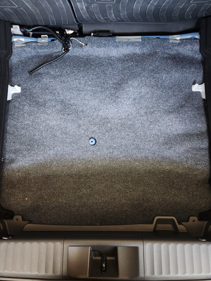

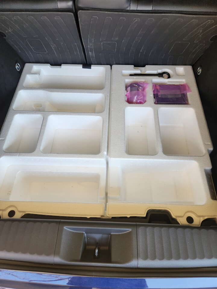

    Here's the stock floor and foam panels:
    03 Stock XLE foam panels with compressor and slime.jpg 02 Stock floor height.jpg

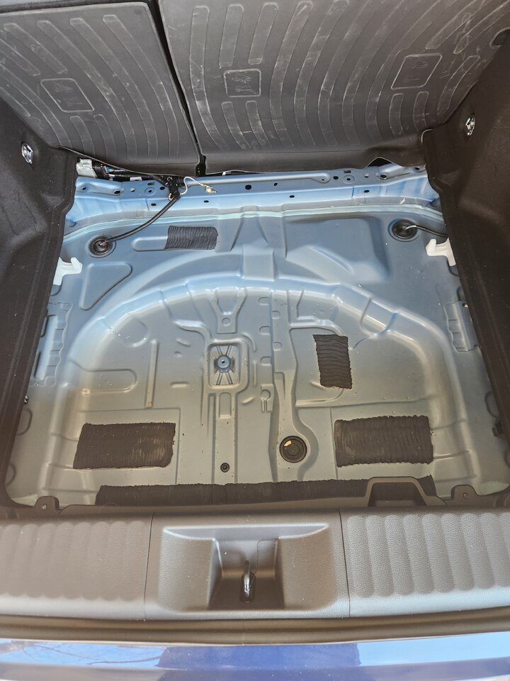

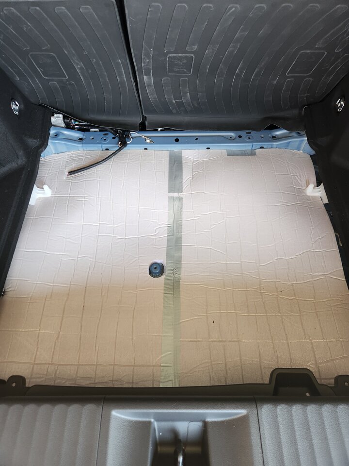

    Remove those foam panels, and there is the bare steel already set for the spare tire holddown. I cut a piece of dense 7/16" polyurethane and covered it with a trunk-suitable waterproof fabric mat called Drymate.
    04 XLE foam panels removed.jpg 05 Polyurethane foam pad.jpg 06 Drymate mat cut and installed.jpg

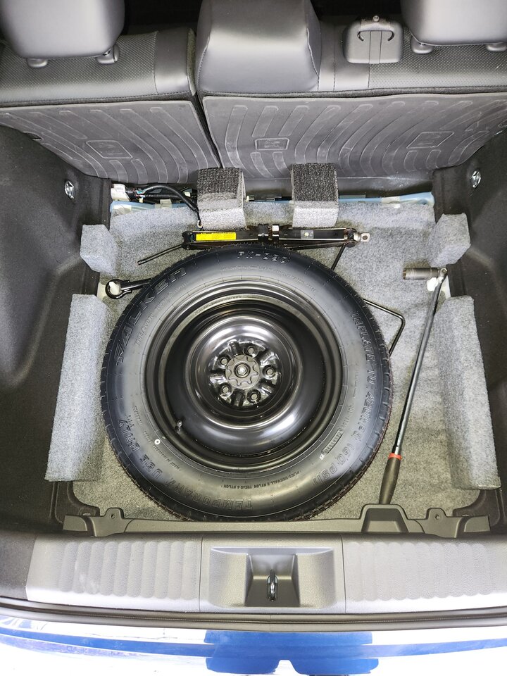

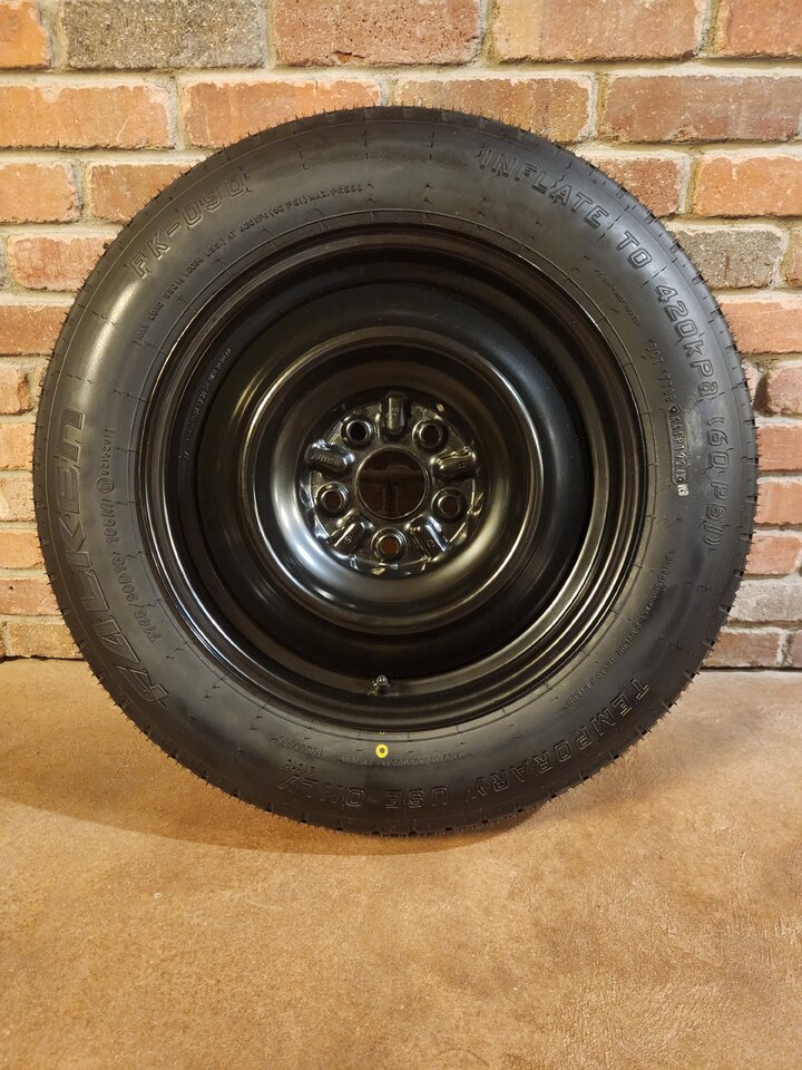

    Spare tire is a Falken FK-090 T145/90D16, which is exactly the same diameter at the factory XLE 195/50/19 Toyo Extensa tire at 26.7". This is mounted to a factory Toyota 16" wheel, Part Number: 42611-21280. This wheel clears both front and rear calipers with room to spare. Hold down (Toyota "Carrier") is PN: 51931-10040

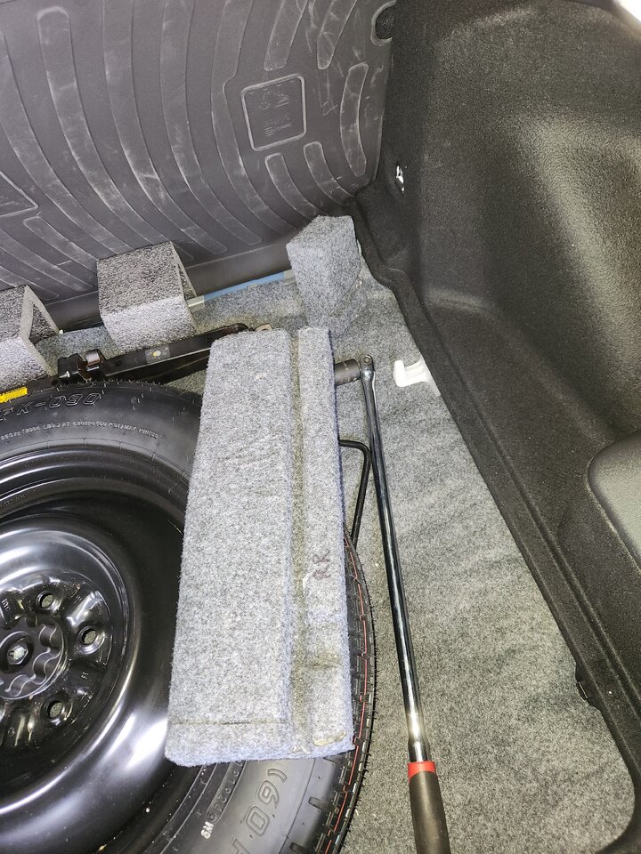

    To provide support of the stock trunk cover, I cut 2" thick pink foam insulation and cuta groove to mesh with the factory floor side panels.
    10 Supports covered with mat.jpg 08 2inch Foamular insulation supports cut to height with soft tops.jpg 09 Backside of foam cut out to fit to side panels.jpg
    Then covered them with the Drymate covering.
    09 Backside of foam cut out to fit to side panels.jpg 11 spare installed with jack tow hook and wrench.jpg
    Jack was obtained at a local auto recycling center from a Lexus RX330, and confirmed to work smoothly and at a major savings from dealer pricing.

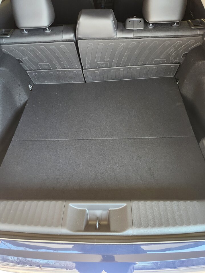

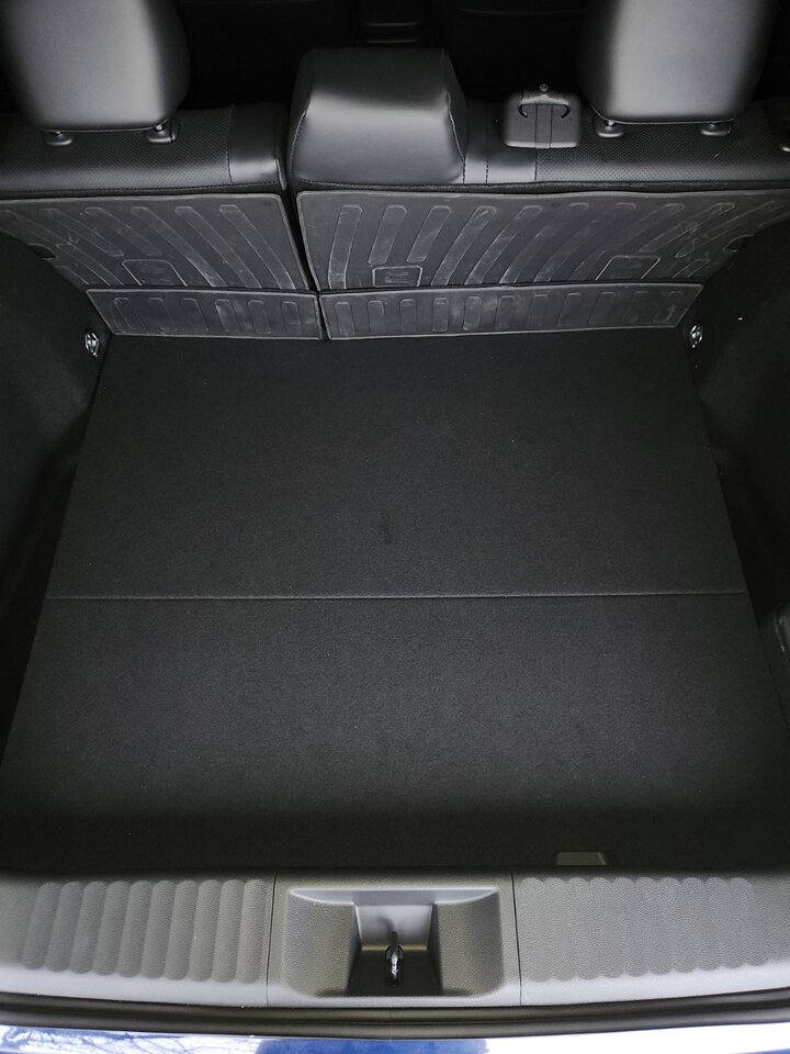

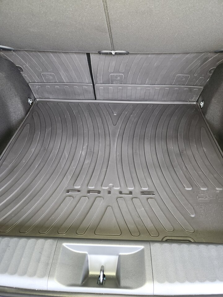

    Here's the end result with the floor back in place:
    Now, no more worries about a blowout or major flat on any of our major highway or rural area drives and at a relatively modest cost of under $250 complete. It would be nice for Toyota to have this as an available option, but it's a pretty easy retrofit.

    Does that wheel work with the Toyota nut with captured washer, or do you have to carry different nuts?
    Ben in IL likes this.
  5. xliderider
    xliderider Senior Member
    Apr 19, 2012
    8,140
    3,277
    Honolulu, HI
    Most Toyota OEM lugnuts have a tapered end that is compatible with the seat on the steel spacesaver rims.

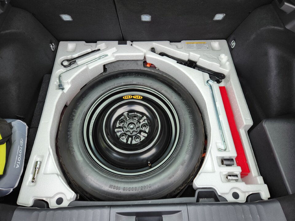

    I still prefer mine. ;)

    Limited AWD-e
    Do it right once, then enjoy it for the next 10-15 years of ownership. ;)
    No creased deck board because it's not supported correctly, no uneven floor because the tire and homemade inserts aren't completely level, no movement when you throw things in the back because the homemade inserts aren't locked into anything, no rattles because the tools aren't secured well and bounce around when you hit a bump, more free time because it takes 15 minutes to install the factory option versus several hours measuring, shopping, fabricating, and installing the homemade options.
    Right now(15% Memorial Day Sale), it would cost a little over $600 for most cars to do the conversion. Includes tire, wheel, tools, and parts(say +$30 for AWD and/or +$90 for LE if you really want it perfect). People who do a custom installation already typically end up spending $200-$250 for the wheel, tire and tools, plus another $50-$100 on other materials to make it all work. So $250-$350 for the make-do solution, or an extra $250-$350 one-time cost on top of that for something easy and professional?
    I mean, I get it, who likes to spend money for something they think should have come with the car in the first place? And most people see that $600 total as a much bigger number because they don't mentally add up everything they're spending on the makeshift solutions(in those cases it's $50 here, $75 there, $100 here, $25 there - those numbers "feel" so much smaller individually). But Prius owners tend to hold onto their cars much longer than the typical owner. Why not spend a couple hundred extra up front to get 10-15 years of trouble-free enjoyment? I just have a hard time understanding the other mindset.
    But I guess that's why I'm a fan of TheCarCareNut, Sarah-N-Tuned, and mymechanics, while the rest of the world seems to be a fan of Mat Armstrong, Donut(less now than a few years ago), Tavarish, and WhistlinDiesel. (I enjoy WATCHING Mat, Tavarish, Hoovie, etc., but I would never buy one of their vehicles. AMD, Sarah, or whatever mymechanics's real name is, on the other hand, I would happily buy from.)

    Xliderider has it right. The factory wheel nuts with the tapered seat work fine with the Toyota spare wheel. I should add- a benefit with the actual Toyota wheel is hub-centric, unlike some of the aftermarket wheels.

    Hi Hammersmith- I like your solution better too, but that cost of entry was a bit dear. I was inspired by your post and some others, and as a "old car" guy, wanted to see what I could make work without being too much of a hack. :)
    You can't tell from the photos, but the deck board is very well supported by the side supports, which are notched to lock into the body panels. Also have a foam piece that sits on top of the spare, and some rigid foam behind the rear seat backs.. Tested it out with four 40 pound bags with no issue. And it is level front to back and left to right- as I spent a fair amount of time setting the heights.
    An added plus is the polyurethane underlayment and Drydeck cover give the area a more finished look that the factory foam. In recent use, it also allowed for easy transition for temporary use with the spare, deck cover, and foldable rear privacy cover removed and not only provided much more capacity, but still "looked" finished vs the painted steel. I do realize that pulling out the factory foam also would just take a minute or two.
