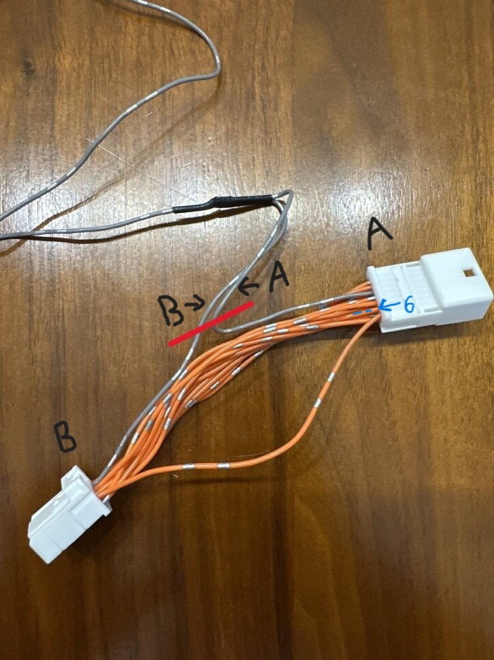

    1. Cut the gray wire as marked in red to remove the extra section. Leave enough so you can still splice the parts of the two gray wires still connected to the plastic ends together to match all the other orange wires. I don't know if it matters, but, just in case, mark which side of the cutout gray section went to which connector so you don't reverse it later(the A/B stuff in the image). I doubt it matters, but better safe than sorry.

    7. You have a HEV, so find wire 6(marked in blue on the image). The gray wire is number 3, so you're going to want the second to last orange wire on the same row. If you have your shifter out while doing all this, you can double check by looking for where the purple wire goes into this new added harness; that's the wire you're going to want to tap into.
    8. Snip the 6 wire in the middle of the span and strip both ends.
    9. Use two butt connectors and splice the extra section of gray wire you cut away in step 1 to the ends of the orange wire you just cut in step 8. Use a little grease just like step 4.
    10. Use your heat source to seal up the two butt splices and you're done.

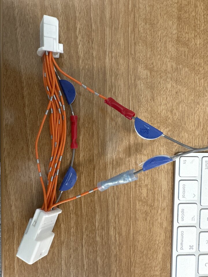

    Thank you very much @Hammersmith, here is the outcome of my wiring. I don’t have the heat shrink on hand, will redo when it arrives. Let me know if this looks good.

    Seems good. Real test is plugging it in and seeing if it works.
    The proper way is to pull the lower center dash trim* to free up the center console trim cover(the whole piano black section including cup holders and hidden storage compartment), but I think you might be able to get away with just starting at the back of the center console trim cover and prying it up just enough to get at the parking brake connector. You'll likely need to remove the shift knob, but that just unscrews.

    It worked! Plugged in and everything came to life. Now just need to button up and clean up wiring, thank you everyone for your help!

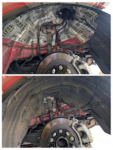

    18. Added sound deadening to rear wheel arches

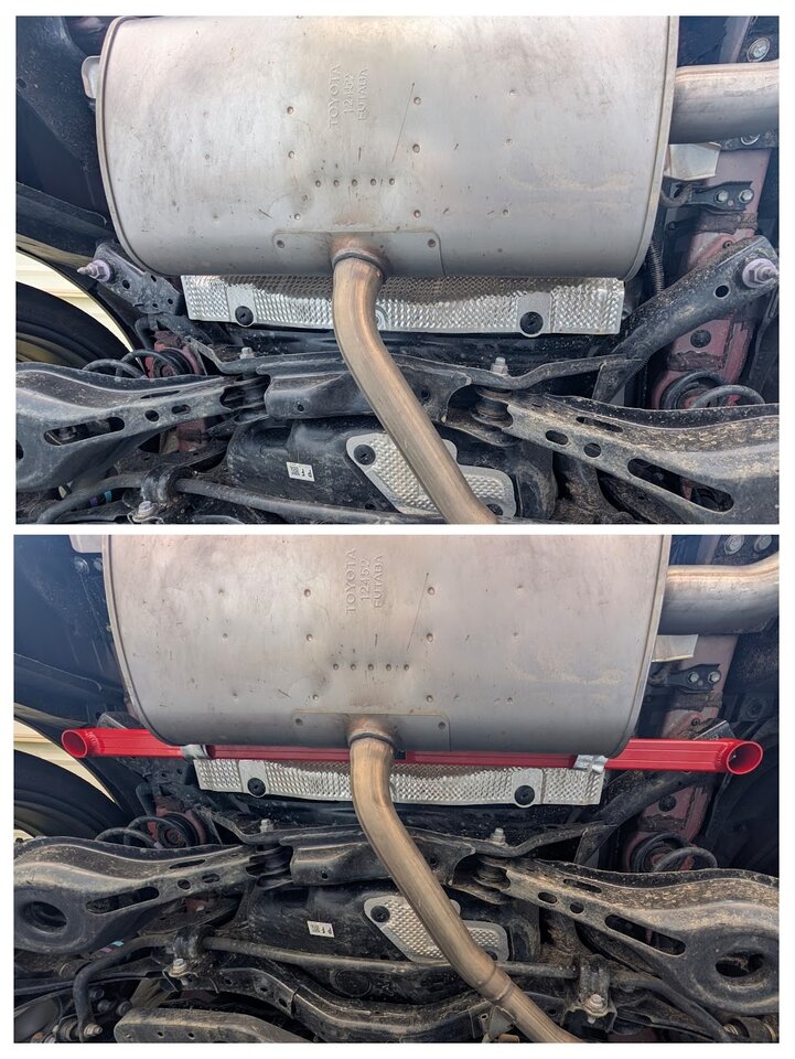

    19. Added tanabe rear under brace (prime muffler makes contact, had to add spacers and hang the muffler lower to clear)

    How thick did you go with the CCF? I'm looking to start doing some sound dampening, and the wheel arches seem like a good place to start. I'm seeing CCF available in half inch and one inch thicknesses, and was curious which you had and if you ran into any issues. A noticeable improvement on rougher roads like what you're seeing (hearing) is exactly what I'm looking for.
