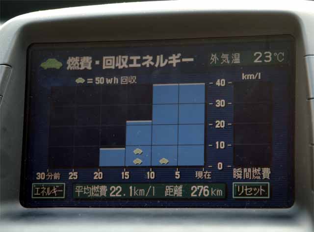

    <div class='quotetop'>QUOTE(Etel Rose @ Nov 1 2006, 08:16 PM) [snapback]341788[/snapback]</div>
    Please refer to your consumption screen when you finished the short trip.
    You'll see something like picture below. It's from Japanese Prius shown as km/L.
    10 km/L ~= 25 MPG
    20 km/L ~= 50 MPG
    30 km/L ~= 75 MPG
    40 km/L ~= 100 MPG
    If you finish the trip in 5 minutes, you'll see 25 MPG.
    If you finish the trip in 10 minutes, you'll see about average 31 MPG.
    I think you already know it is casued by warming up fuel use.
    Ken@Japan
