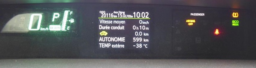

    cold start , i mean REALLY cold start at -38 : took
    me 4 shots... at first 3 shots, motor made horrible knocking
    and barely turn... was impossible to stop the start sequence
    with start button and battery died all 3 first try... i'v waited
    2 to 5 minutes between tryout... finaly , after 10 minutes delay
    between trial 3 and 4 ... the fourth time worked ...

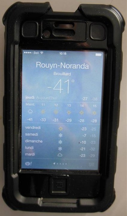

    -41 yikes. One of the reasons that I moved from Montreal to British Columbia. Bonne chance mon ami.
