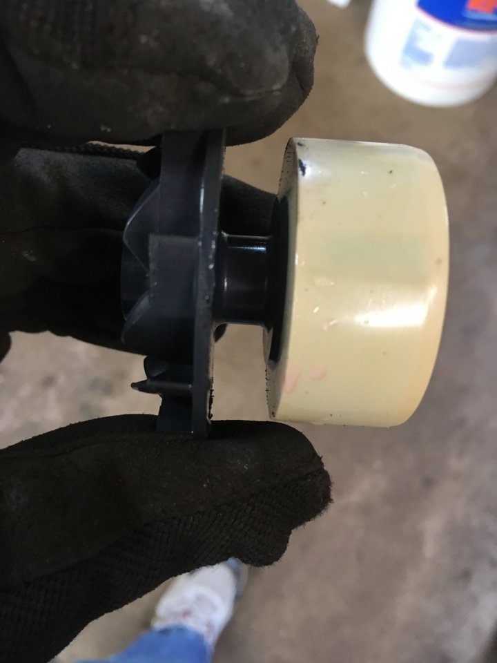

    As an owner of a 2010 Prius II with over 156 k miles and going strong, our Prius had a small drinking problem,but is manageable. I change thenoil at 10k miles and do some other things along with experimenting with various 5w-30 synthetic oils. The key is to pop the hood and check the dipstick before the dash light tells you to;).
    The other issues cited by the OP, I do not remember any reports of actual water pump failures (but I have been having long days at work so I might not remember well:(). As someone who has removed and replaced the Gen3 mag drive water pump (and tore it apart;)), the weak point in the design is the plastic impeller, IMO. @m.wynn 's water pump at 140k miles looked good, but he was looking for piece of mind.
    I plan on replacing our water pump at 200 k miles in a couple of years for the same piece of mind;). But that assumes I don't get a Prime before that (y).

    Since the water pump in the Gen3 is magnetically driven (seal less design) and not belt or mechanically driven, it should "last the life of the car", much like the Trans fluid. Here are some pics of the water pump after logging 140 k miles:
    IMG_0353.JPG IMG_0354.JPG IMG_0356.JPG IMG_0357.JPG IMG_0358.JPG IMG_0359.JPG IMG_0360.JPG IMG_0361.JPG IMG_0362.JPG IMG_0363.JPG
    With the Gen3 water pump design, there will not be the overt signs of failure like we are used to (coolant seepage, noise, etc). The tabs on the impeller seem like the weak link as it took very little lateral force to separate the 2 halves of the impeller.
