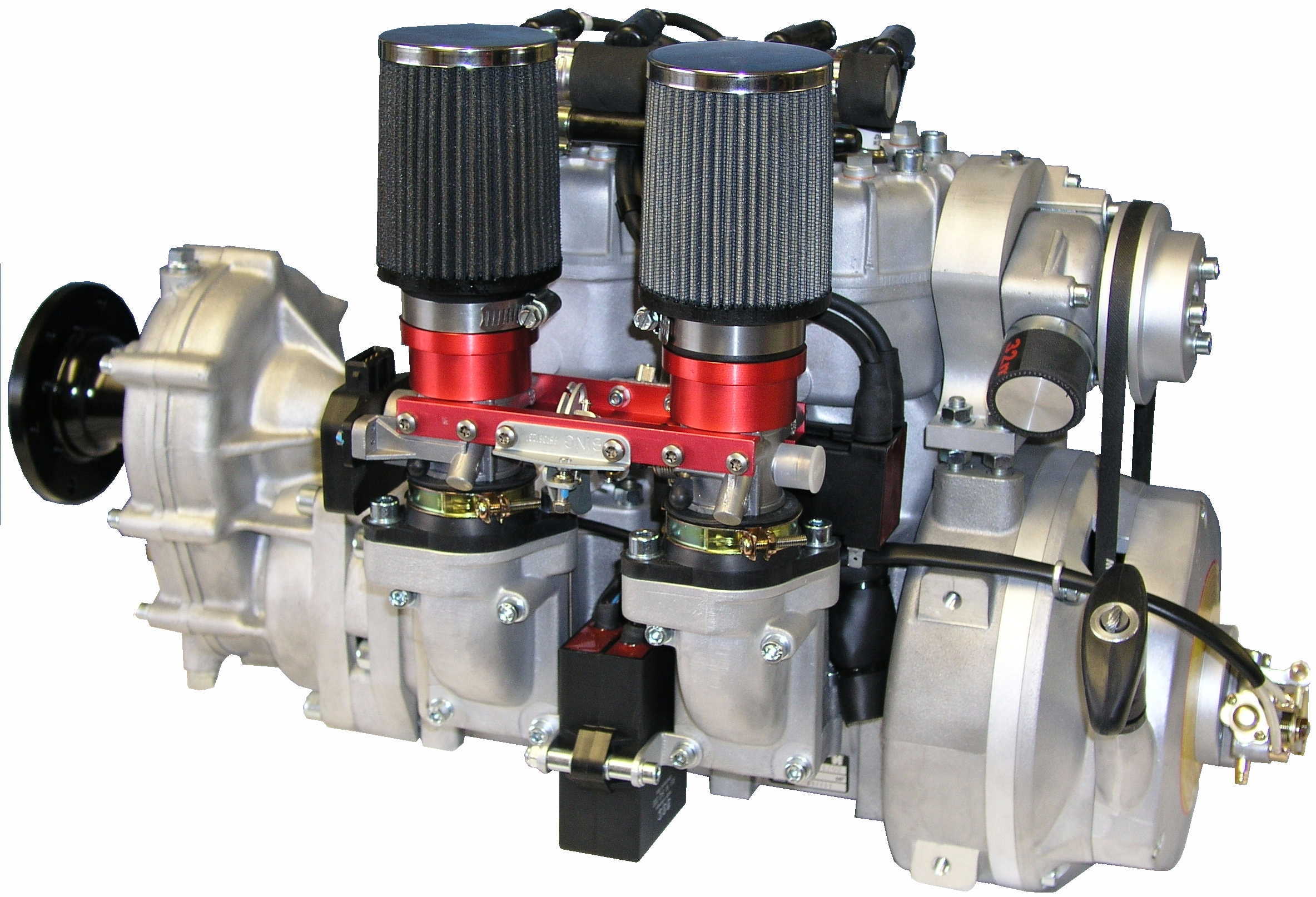

    I will be looking at:
    A Hirth 3502, 60 hp, two-stroke, oil injection, fuel injection, dual-spark, water-cooled, and geared prop 2350 rpm engine. Consumes oil 50:1 or using recommended oil, 100:1 which means no oil changes. Expected weight ~128 lbs.
    It replaces this:
    [​IMG][​IMG]
    A 60hp, 3200 rpm, four cylinder, 1830cc, converted VW engine, carb, magneto+electronic backup, HAPI conversion with a history of prop flange fractures. Measured weight 172.3 lbs as shipped.
    The new engine will go in this:
    Not shown, the wooden 52"x40" prop will be replaced with a 52" electrically controllable pitch prop that at 2350 rpm happens to have exception efficiency. This prop handles the narrow power range of the Hirth, two-cycle and handle some of the unique loading characteristics of two-cycle engines:
    • Too much pitch and the cylinder heads get too hot - the pistons melt
    • Too little load and the exhaust gets too hot - the piston rings melt
    Cabin heat uses waste, heated air from the radiator, no carbon monoxide risk. The water jacket reduces engine mechanical noise. The required, resonator muffler reduces noise and is located on the opposite side of the pilot.
    Radiator hot air exhausts out the sides into side-pressure air instead of the bottom improving climb cooling. The radiator cowl flaps will have three positions:
