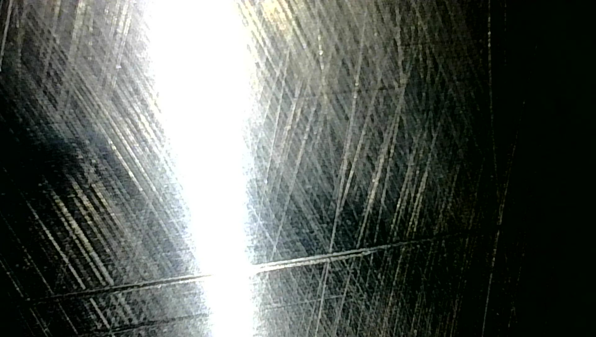

  6. Isaac Zachary
    Isaac Zachary Senior Member
    Jan 20, 2018
    2,764
    1,487
    10,000 mile oil changes will kill the engine in around 150,000 miles. Deposits start forming around the rings and in the oil relief holes behind the rings since oil loses its ability to clean and suspend the carbon in it over a period of time. Frequent oil changes avoid this problem.
    With the oil relief passeges clogged, now the rings start to seize as they get gummed up with stagnent oil and crud. At this point the engine is still saveable if you can free the crud from around the rings with some strong detergents (oil flush additives or high detergent oils) although using those for too long may also ruin your engine (or at least catalytic converter). You will also start noticing greater oil consumption when this happens.
    After that the rings will start to scratch and eventually gouge the cylinders. This is now the point of no return as there is no way to restore the cylinders back to original condition since Toyota used thin walled sleeves that are practically irreplaceable. The only fix is to replace the block.
    I'm saying this from experience as I have a 200K engine with gouged cylinders from 10,000 mile or yearly oil changes. The engine chugs oil, using over a quart per 1,000 miles, and the catalytic converter is of course dead as a result.
    Here is a pic from my engine. Note that there are many, many Toyota engines that have gone through the same exact problem:
    I suggest doing a brake fluid flush every once in a while since the brake controller on these cars is very expensive ($2,000 or so). Keeping crud and moisture out of it should extend its life so is cheap insurance.
    If you don't take care of the car then at around the same time, around 200K miles, all four major items can go out:
    • Engine block
    • Catalytic converter
    • HV battery
    • Brake controller
    At around $2,000 a pop for each if brand new (you can get a JDM engine for less, and the catalytic converter depends on your state) it can be as much as $8,000 just in parts to fix a uncared for Prius that the owner thought it was a good idea to do 10k mile oil changes and such.
    Or take care of it and all you'll have to worry about is the HV battery.
