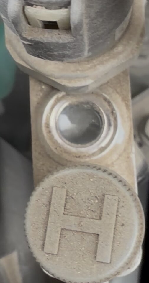

    I fired up Techstream and in Active Test mode I can ramp up the compressor speed to 7500 RPMs (as shown) but it doesn't make much if any different in the air temp. I can see liquid in the sight glass and the pressure sensor in Techstream shows about 150-155psi so it's not empty, though I'm not sure what that sensor reads normally. If the engine is on battery when parked and I turn the A/C on high the engine typicaly kicks on and it sounds like the compressor is buzzing, but again I'm not sure what's entirely normal on these vehicles since I know the compress operates differently.

    Low refrigerant means there is a leak. The sight glass with a leak will show bubbles/ white foam occasionally or all the time depending how low it is.

    Partial foamy bubbles
