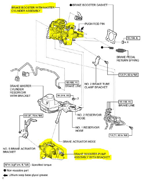

    The C1391 is a report of pressure leakage, so leakage has been observed, just not by you. :) The leakage can be (and often is) internal, so no brake fluid ever leaves the car, just finds its way back to the reservoir.
    In a Gen 3, there are two different assemblies where such leakage could be happening: either the "booster assembly with master cylinder (includes actuator)", or the "pump assembly, brake booster" (also known as the accumulator). Neither one is a picnic to replace, so if you have a way (if it's leaking fast enough, a mechanic's stethoscope might work) to determine which assembly you need, that could save some time and money.
