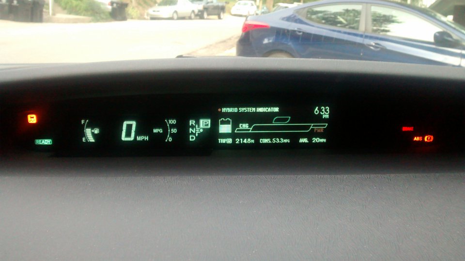

    Hello,
    I currently have a 2010 Prius with 43K miles. Driving home from work today, all three lights came on and the brake pedal was very soft. (see attached photo)
    I tried to search this issue on the forum and have gotten a range of possibilities from 12v battery to the master cylinder ($3,000 in repairs). The service department at the dealer is already closed so I'll have to take it in the morning.
    Anyone else had this issue recently? Could it be anything else...I'm trying not to freak out about the $3k repair especially since I have 11K left in payments for the car!! It feels like master cylinder failure.... :((
    If it ends up the latter, can I take it to a regular import dealer to have them do the work...?

    52,819
    absolutely. anyone can do the brake master cylinder, and you can get them a lot cheaper than the dealer charges. all the best!(y)

    So what was the cause of the lights - the bad hub?

    It was a bad right rear ABS sensor. Replaced the hub.

    I had these lights come on intermittently. I wiggled and tightened the rear wheel speed sensor connectors and cleaned the front speed sensors and put them back in. That seems to have fixed the problem.

    It is easy to get the trouble codes when these three lights come on, which is how you find out why the brake ECU has put those three lights on. It's approximately useless to base anything on just "had the same 3 lights" because those are the only 3 lights the brake ECU has to alert you to problems with, and it uses them for pretty much all one or two hundred reportable issues.
    If you don't have a scan tool, you can still get the trouble codes using nothing more than a short piece of wire, and counting the blinks of the lights. There are a lot of posts here on PriusChat on how to do that.
    If you retrieve the trouble codes and the ones you get are about wheel speed sensors, then that would give you a good reason to at those sensors, as robomoto has done here.
    If you retrieve the codes and the ones you get are about something else, then you would probably skip fiddling with the wheel sensors so you could spend your time checking out whatever issue is really being reported.
