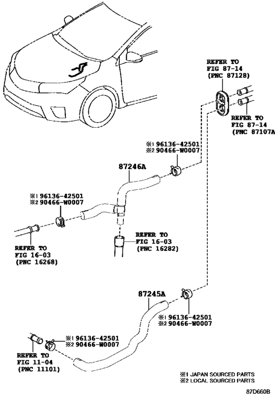

    The last car I worked on that used a valve on the water side of the heater core was an ex's 1965 Galaxie 500. (I remember a newer car that worked that way too, a Mitsubishi from the early '70s.)
    The always-hot heater core with a blend door that sends the air either through or around it, and no water valve, is pretty common in "a regular car" in recent decades. You feel the temperature change immediately when the blend door moves. People like that.
    And in a Prius, "my A/C blows cold when the engine's off but blows hot when the engine's on" is pretty much pathognomonic of a blend door that's stuck in the heating position.
    What year Corollas? I looked up a random 2016 Corolla heater core piping diagram ... no water valve.

    Yeah I generally drive really old cars like 82 Corollas 74 Corollas stuff like that but at least down here in this house I know in a pinch I can just put the heater hoses together outside under the hood and then have no heat anywhere in the cabin isolated insulated or not It just won't be there I mean even in the winter I don't run much heat I'll put it on you know when it's icing and what have you but that's about it I'm in my outdoor clothes. So I just reconnected in about late December and then in May put the connector in and put the hoses together because the summer's long and hot and hotter as the years move forward it seems.

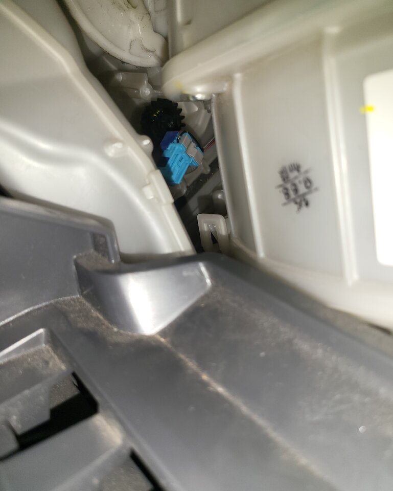

    yep, I had the glovebox and that little cover under the glovebox removed but even then still extremely tight to try to get something in there to unscrew it off..
    looking at how it functions from under the dash, clearly it has a problem, moving from cold to hot and back shows it attempting to turn the gear but it barely budges. thought that it was definitely a bad servo but interestingly after my wife had driven it yesterday, i show that it actually properly turned the gear but sadly not all the way so it was still letting a little bit of the hot air from the engine come through. for s&gs, i fiddled with the temp again, as soon as i moved it to heat, the gear actually moved pretty smoothly across 5 or 6 teeth and then stopped..when i moved it back to cold, the gear attempted to turn the other way but stopped before half a tooth...
    are broken teeth common on these? i searched through the forum and aside from one person who thought that they saw broken teeth, it doesn't appear like a common problem and not sure how it would have broken :(

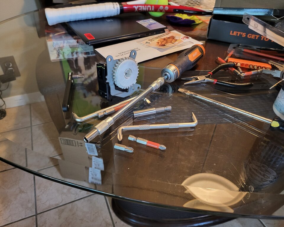

    Man, those 3 screws are the worst to get to because of that little air tube that runs directly in front of the servo as it doesn't appear that it is removable. With a lot of patience, I was able to get the bottom screw off using a small offset screwdriver. Then I was able to get about halfway of the screw above that one before calling it over the weekend. I can't imagine how I can fit anything to get that last screw in the back..
    Yall have some good suggestions for tough to reach screws? I thought using a tiny socket wrench would work but none of my tools are really small enough to work except for these tiny offset screwdrivers but it will be of no use for the screw in the back!

    Finally got that sucker out after a combination of all the small tools I had and luckily it was definitely the servo that went bad. I don't see any broken teeth and I was able to turn the black gear on the core all the way in either direction. Then was able to test and yup, AC stays cold now while the engine is on.
