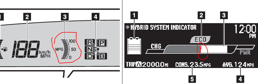

    Every morning when I go to leave I start the car and instantly put it in ev mode to drive the block down my street. Once I pull out from the stop sign I disengage ev mode just before I accelerate, but I have noticed that going the .5 mile to the next light that my mpgs are over 50 under acceleration and going up a hill at 35mph. I also notice that by the time I get to the top of this hill that my battery which was at 4-5 bars is down at 2 and the engine has to run till it regens some. My gen 2 had a similar bug but unlike this one by flooring the accelerator I was able to get it out of it. This gen there is nothing I can do till I come to a complete stop and when I pull out again it's back to norm except the hv battery being drained to 2bars. Because of this I am struggling to maintain 44mpg. I reset my trip B this morn and for the 5.6 mile trip I barely got 39.8 mpg.
    Is there anyway to avoid this or get the car out of it without stopping?

    As alluded to by others, the early stage of ICE warmup doesn't produce much power - maybe 1/6th of the HSI bar or so. This phase lasts for about the first minute that the ICE is running. The most efficient thing during this time is to stick to slow speeds and very light acceleration - so it's probably perfect for a leisurely drive to the end of your block. You can basically set your clock by when the car is ready to produce power - the first 12 seconds, the ICE will be off. The next 50 seconds it is on in Stage 1 warmup. After that, it's ready to give you whatever power you need for acceleration - until then, it's going to mostly use your battery power.
    So try ditching the EV button for a while, and see if you can find a happy place where your battery stays charged because you're not accelerating too hard too early in warmup.
    On the regular "hatchback" Prius, you can't. The EV speed in the US is limited to 25 mph. Until 45 mph, you can still drive with the engine off, but not with the full acceleration that being in EV mode allows. Above 45 mph, the engine is always spinning (though not always burning gas) to prevent the motors from going overspeed. In the PIP, you can stay in EV until 62 mph, at which point the engine has to come on for the same reason.
    In any case, it's more efficient to use the engine at that speed anyway - the power you need to counter friction and aerodynamic drag at that speed is high enough that the engine is running in a fairly efficient power range. At 15 mph, it doesn't take much to overcome friction and drag, so EV is fine.
    Basically, you should only use EV if you need to move the car from the garage to the street, or if you're going to tool around a parking lot (and not immediately leave), and similar things. If you just have a minute of low-speed parking lot driving before hitting the street, as above, you're better off not using EV and letting the car get warmed up instead.

    That's pretty much it. Give it a few weeks, just letting the car decide. Any time the display of instant mpg goes up to the top (US car), you can be assured the engine is off. It's usually apparent by sound/feel too. Above something like 45 mph there will be RPM, but apparently no gas used.
    With the car warmed up, when you lift off the gas, then gently reapply but keep the HSD bar below middle mark, the car should stay EV, as evidence by the instant mpg display.
