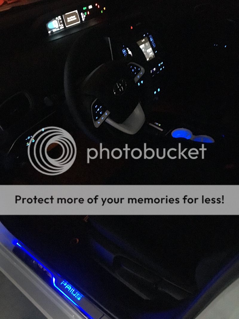

    stanigu,
    You asked how bright the LEDs were. Here is the night shot I promised.
    While I was taking pics, I thought I would throw in a pic this little mod (new door lights)...
  10. stanigu
    stanigu Member
    Aug 30, 2016
    62
    Blackhawk, CA
    Thanks! Looks good--It doesn't seem like the brightness would bother too much. It looks pretty blue though in comparison to the rest of the dash--does it have the "OEM" look?
    Love the pacman too!

    62
    Blackhawk, CA
    Thanks! I went with the blue ones like you did. I was really torn between the blue and white, but I noticed that the blue from the illuminated door sill looks very similar to the blue of the cupholders, so I thought it would go well.
  16. stanigu
    stanigu Member
    Aug 30, 2016
    62
    Blackhawk, CA
    It's done!
    Thanks for the instructions and inspiration. The blue matches perfectly with the door sill lights. Neat.

    Awesome! I glad the blues match so nicely. Now, my wife wants to do the door sills :)
