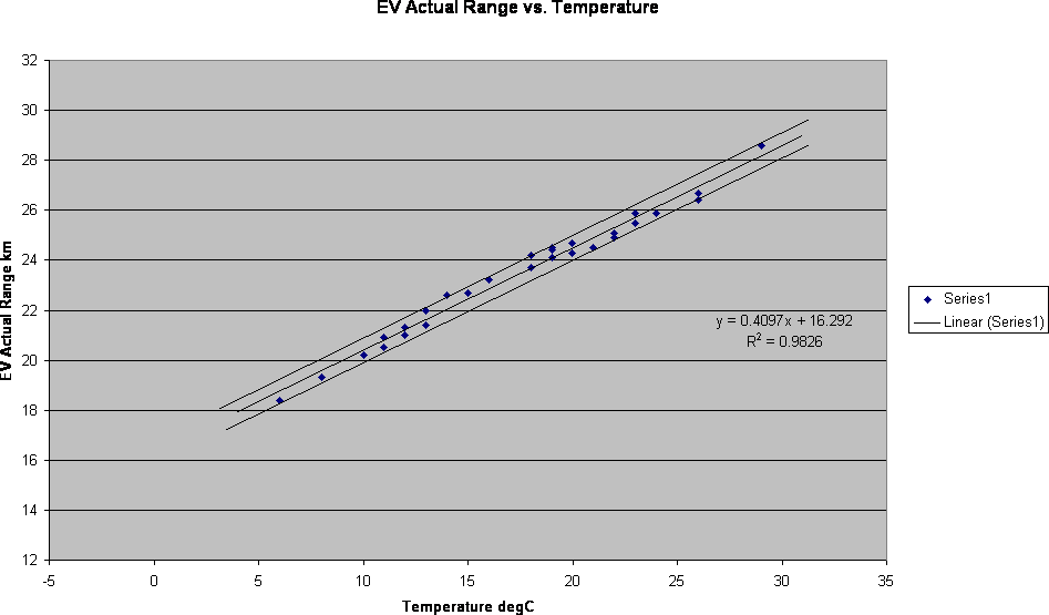

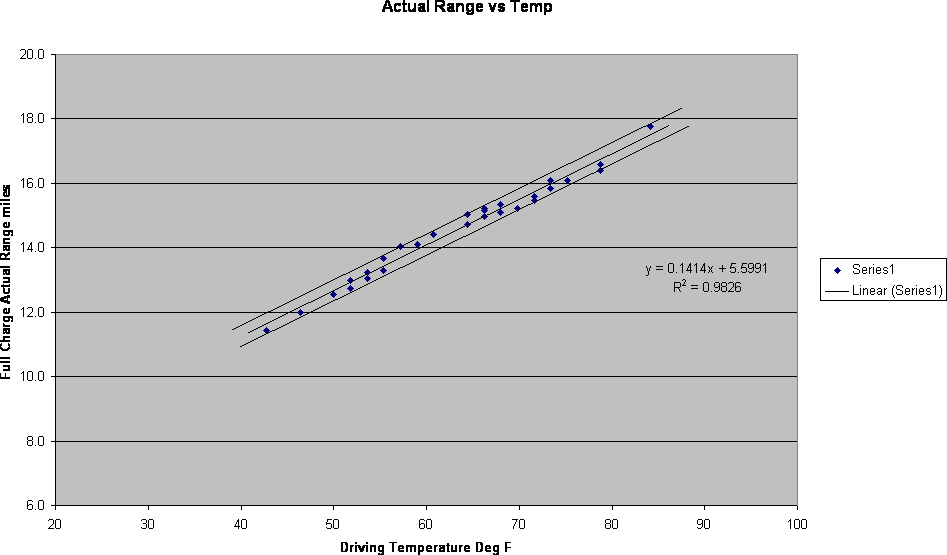

    Temperatures lower than 6-7 C are very rare in my area, and I will probably use cabin heat (as an order from partner), so yes, it is very unlikely that I will add low temps data points.
    All my recorded trips are with 1-2 occupants.
    My curve fittings to my results were only to have another tool, example - linear regression with 0.14 slope indicates to me about 1.4 miles drop (or gain) per 10 deg F.
    I do realize my results were not achieved in a lab and cannot be reproduced, also - similar conditions are only similar (traffic, wind etc.) another difficulty is temp which is not always constant along the trip.
    On the other hand, I took several times this trip with another route (shorter by about 300 m but more traffic lights) and got almost same results for a given temp.
    I hope you will enjoy your new PIP as I and others here enjoy - it is an amazing machine.
    I have added some more trips to the charts, now 28 altogether.
    I have also improved the appearance for better readability.
    The middle line is a linear regression of the data points.
    The two other lines show what can be called "bend of high probability": for every temperature it shows what most probably will be my actual EV range.

    this is right in line with what i'm seeing. are you trending warmer or cooler?
