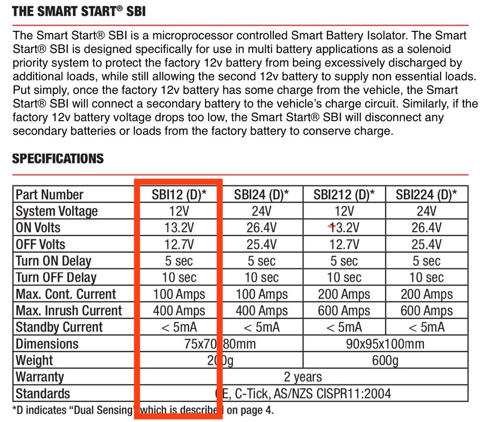

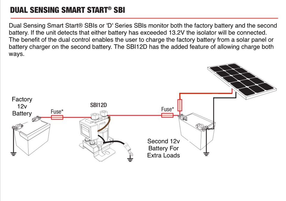

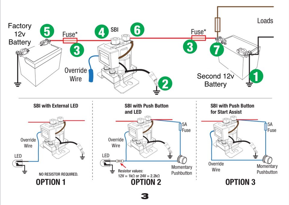

    With SBI12 or SBI12D Battery Isolator. Battery names edited for hybrids.
    Basic Setup for Extra Loads (with Optional Status and Control)
    With Solar (assumes solar panel has regulator for direct connect)
    Finally it is technically possible to connect the cooler to the load side of the SBI12D battery isolator without a second battery and still protect the factory 12v battery charge.
