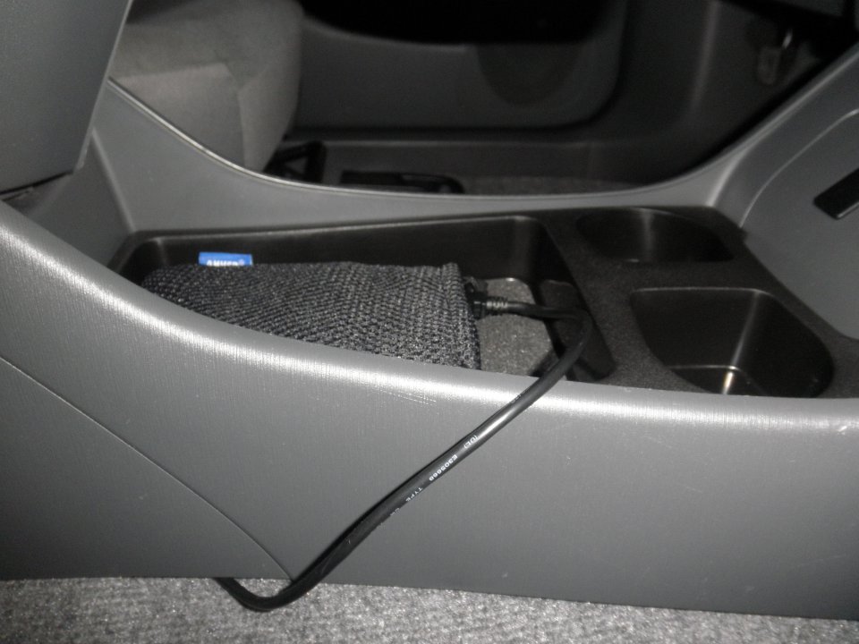

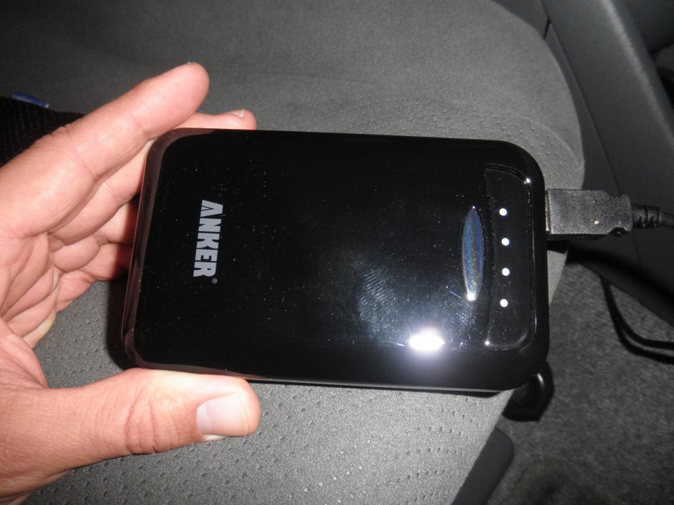

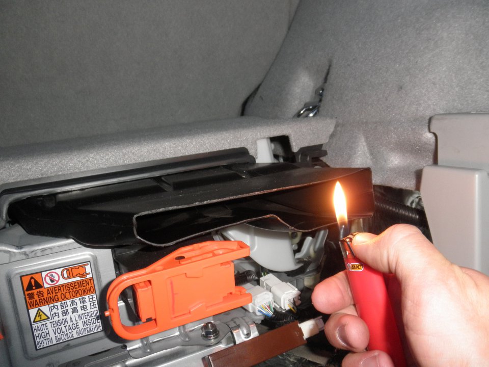

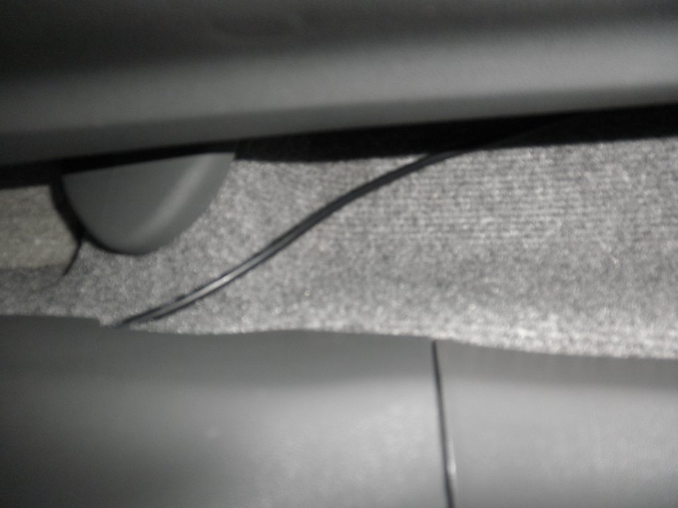

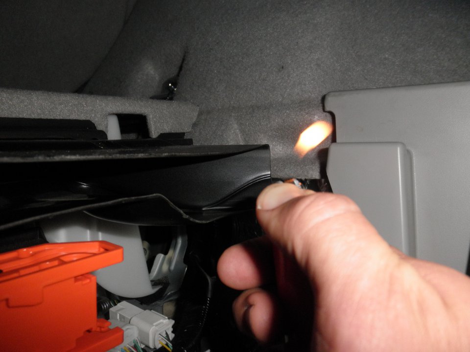

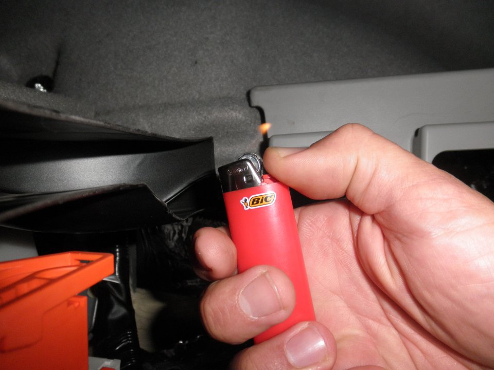

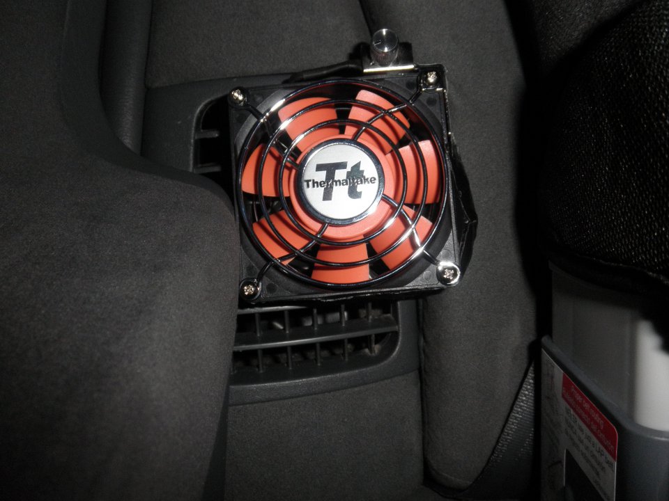

    I installed the additional fan about 2 weeks ago. First let me show you the tools.
    Total: Estimated $50.00
    Goal: Lower the traction battery heat by providing additional cooling. This will also aid the traction battery cooling by not having to run the air conditioner colder to keep the traction battery cooler. I like to feel comfortable in the car not frigid. This alone will boost MPG's. The fan will also aid in pulling cooler air into the air vent so more cooler air reaches the battery faster. One of the most important features is when you turn your car off you can leave this fan on for a few minutes so that it continues to cool your battery down. The cars traction battery fan doesn't do this as it turns off right after you turn your car off. Heat is the hybrid batteries enemy so this is a plus.
    Details:I decided to buy a battery pack so I wouldn't use any of the cars power for this. The cables are tucked underneath the back seat, into the side rails, back out from underneath the passenger seat up to the middle center console. The fan is mounted externally. I can mount the fan internally which would make it completely clean but I want to make sure I can see the fan just in case it would happen to fail. Eventually it will mount inside the air vent. In the future I will route the cable underneath the rug and will make a small hole to route the cable through the center console just to make it cleaner.Fan noise is minimal. I can also adjust the fan speed. The battery has lasted the whole 2 weeks on 1 full charge. Im still at 50% power running the fan at full power.
    Test: Phoenix AZ to Flagstaff AZ. About 300 miles round trip. Elevation that was climbed was equally lost coming back. Estimated 1,100 ft Phoenix and 7,000 Flagstaff (about 6000 ft difference. Same gas. Speed 65 Miles per hour except down hills were I glide. First trip without the fan 50.2 Mpg's. With the fan 53.4 Mpg's. Any variables i could have controlled I did. 2011 Prius III Hatchback 40,000. Tires are shitty Primewell Valera at 44 PSI front and back (came with the vehicle).
    Outcome: Very happy with the results. I gained a bit over 3 Mpg's on this trip. As you can see in the pictures and videos the air flow is strong. I tested this with both the car off and also with the car on. The airflow which is passing through the inlet vent, battery and the the outlet is still strong enough to blow out a lighter. I really like that I can cool the battery faster when the car is off after using it for a while.
    Alright.....You guys can start the bashing now....

    Quick update. Its been a month since I installed the fan. Before my avg was 50-51 mpg's. Now its 53-54 mpgs. The temps are still in the 100's here in Phoenix, AZ. I havent changed anything else on the car that would help boost the numbers. I really think that the extra cooling works.
    One thing to notice is that I leave this fan on running at least 30 minutes after I turn the car off to help cool off the battery faster. If Im doing short trips where Ill get back in the car in 15-20 minutes I just leave it on. Ive read threads in the Priuschat community where the excessive heat will prevent the battery from charging fast (even drain it a bar or 2). The normal fan stops cooling when you turn off the car which leaves the battery "cooking" in heat. When you get back to your car the battery is hotter than when it was on 15 minutes ago. I beleive that aiding the cooling post battery operation helps it cool faster keeping it in a better charging enviroment for the next time you turn on your car as well as when you use the car in EV mode. A cool battery (not cold) will operate and charge better.
    Ive been doing the same 50 mile route everyday. The only change is that I routed call the cables under the rug and made a small hole inside the center console to keep the portable battery in there. The fan is no longer at the exterior of the vent. I moved it inside the vent and removed the metal covers. I can charge the battery in about 8 hours with a 3.5 amp charger and it will last me about 2 weeks of everyday use. If you have questions let me know. I can provide pictures if necessary.
