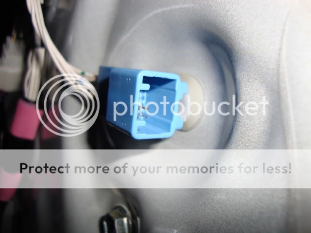

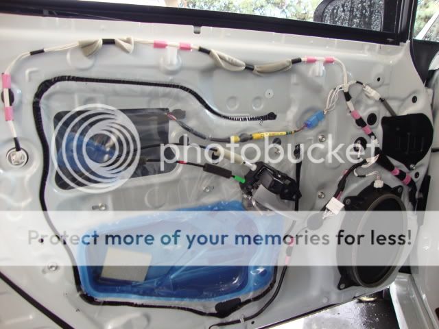

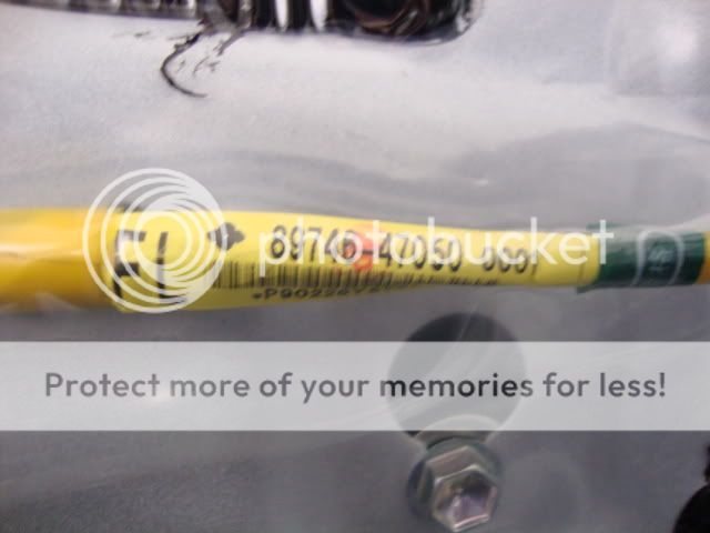

    I was working on my side mirrors so I have to take my door panels off. After taking off the passenger's side door panel on my Prius II, the blue harness drew my attention. Then, I took off the driver's side and realized that blue harness was connected to the SKS door handle.
    zoom-in on the passenger's door
    Driver's side
    cable with part number

    Thanks, Civic. Unfortunately we've already determined that the wires connected to that harness in the passenger door don't make it all the way to the ECU... they end in the junction block in the passenger footwell where all of the wires from the passenger door come in. Additionally, we've also determined that the ECU on the 1 door SKS cars is different than the one on the 3 door SKS cars and even connecting the wires to the proper locations on the ECU won't enable SKS on the passenger side.
    However, the fact that there are wires that go from the door into the car make this project easier as we won't have to be trying to feed wires through there and we've also discovered that we can connect the handle in parallel with the one on the driver's side to enable SKS on the passenger door.
    I already have all of the parts I need for this mod, so look back here on Thursday and if all goes well I'll have a writeup done and posted:)
    Also note that the part number for the cable that you posted is specific to the driver's side. If you want the cable for the passenger side you need part number 89746-47040.
