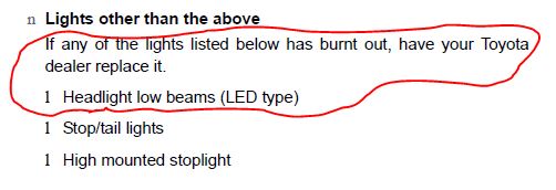

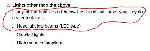

    Close to a grand, just for parts? Ouch, we have the LED headlights, joy...
    Only mention I could find in Owner's Manual. Pretty low key:
    #15 Mendel Leisk, Jan 16, 2015
