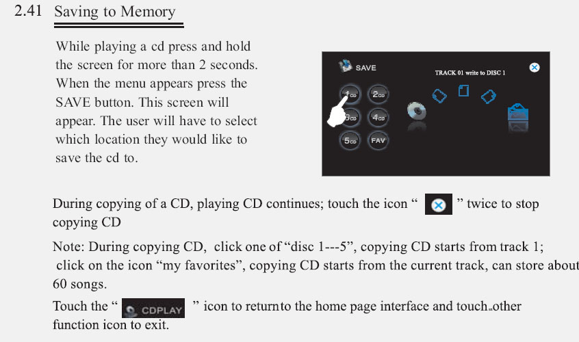

  10. xcuter
    xcuter Active Member
    Apr 27, 2013
    303
    182
    I cant get the option to save. Am I doing something wrong?
  11. evpv
    evpv Active Member
    Apr 19, 2010
    690
    337
    West Coast
    2019 Prius Prime
    xcuter likes this.

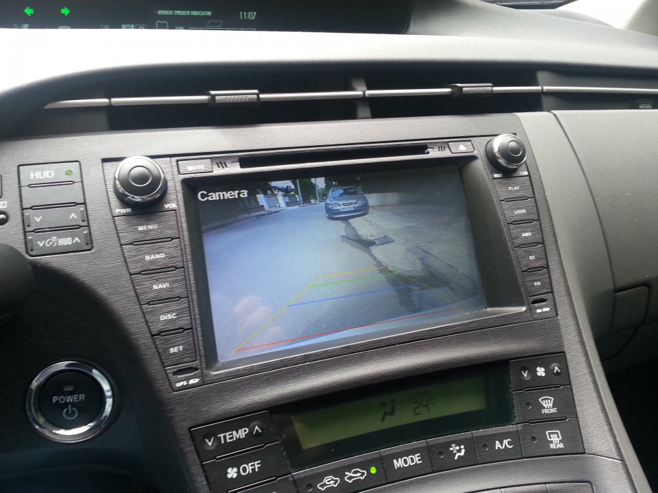

    I installed the backup camera this morning and, like other posters have said, it took a few hours. Fortunately everything works as planned. I added a switch so that I can activate the camera manually whenever I want. One unexpected observation: when the camera is activated, the music, whether playing the radio or through the aux input, becomes nearly inaudible. It returns to normal when the camera is off. It seems to be a function of the design of the unit.

    After tech support sent me a new sd card, the navigation is working. I installed the camera yesterday and everything is working great. It did take about 2 hours to install. There are a few things wrong with the HU but I am pleased with the unit for only $290.

    Congrats on a good install. I can live with the audio cutouts for backup camera, voice-prompts and BT. But what I've discovered is the unit needs a "boot-up" time before the camera turns on. I'm usually ready to be in reverse long before it's ready so I don't see what's right behind the car at first. Oh well, who knew. The solution is to sit there until it is ready.

    I noticed the delay as well. Fortunately, it is not long, about 5 to 8 seconds I think. The main reason I installed the manual switch is because when i leave in the morning I usually just "bump" the car in reverse, with most of the reverse motion by momentum in neutral. That way the engine doesn't fire until I am ready to go. The switch allows me to have the reverse camera on the whole time. It would be better if it could come on instantly on startup, but it is tolerable.

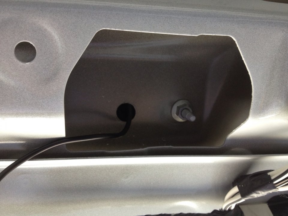

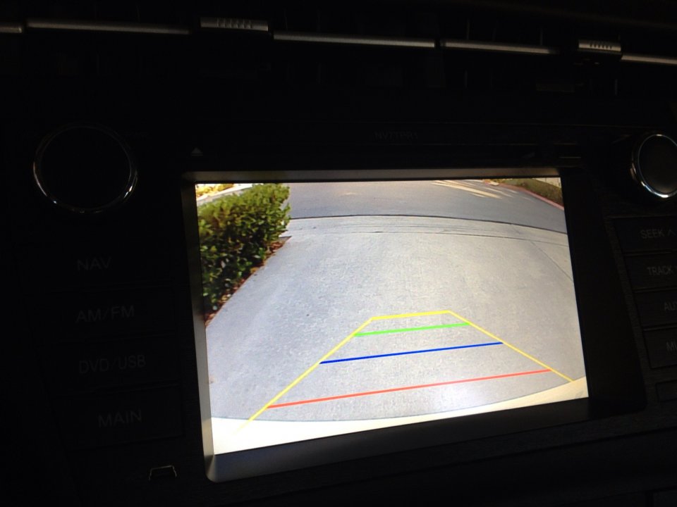

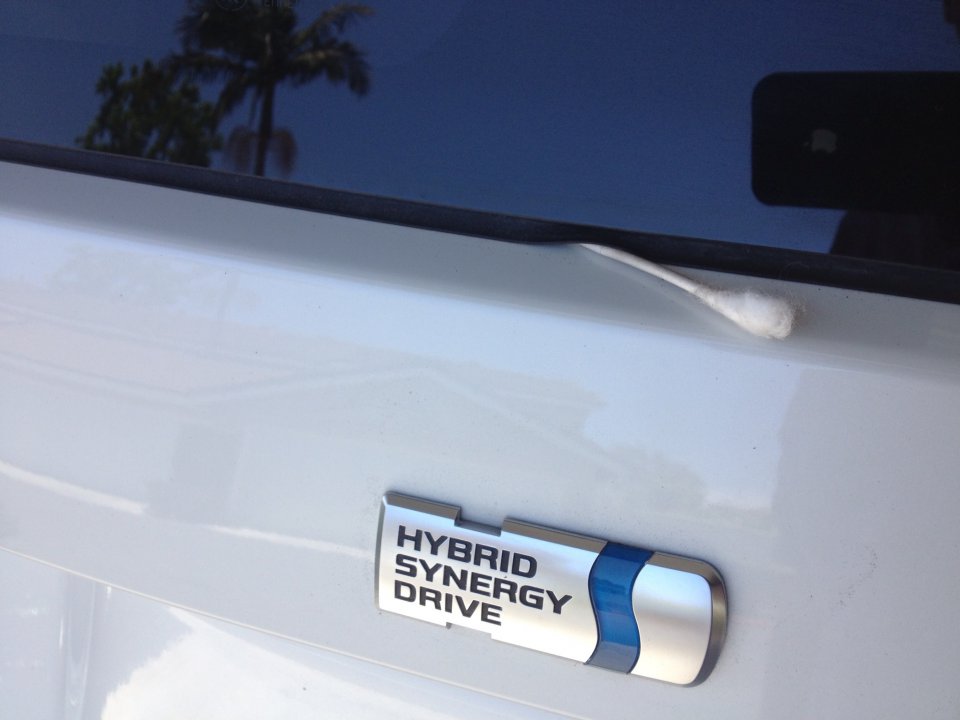

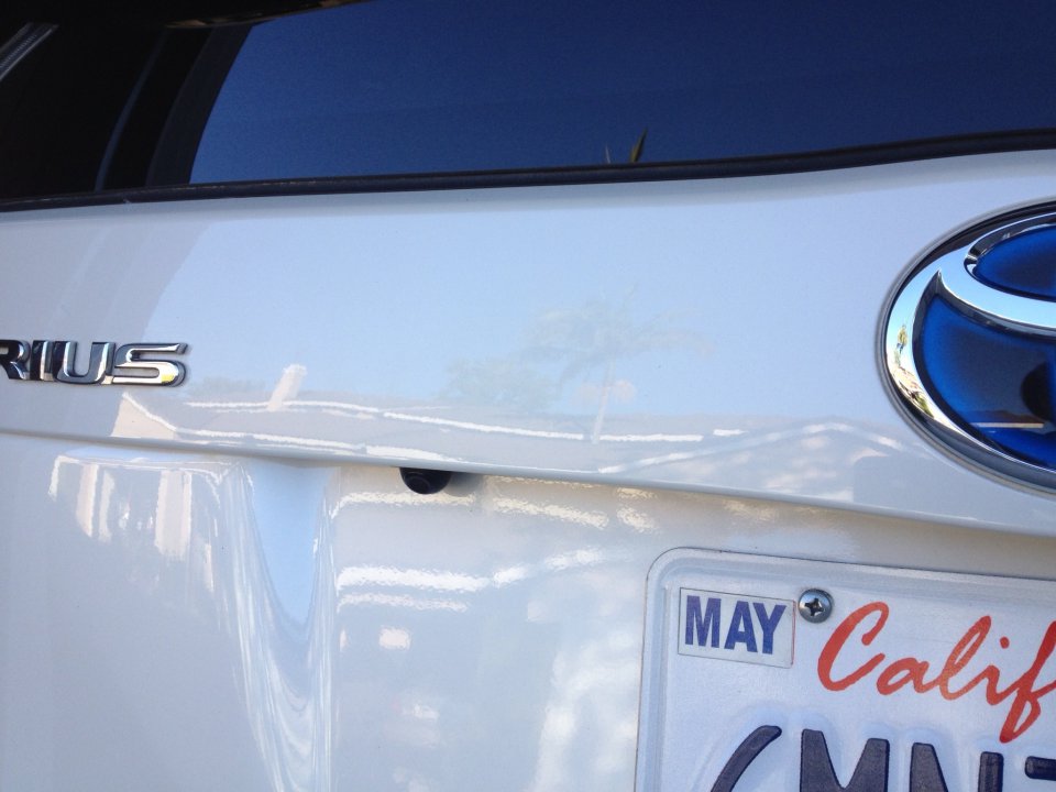

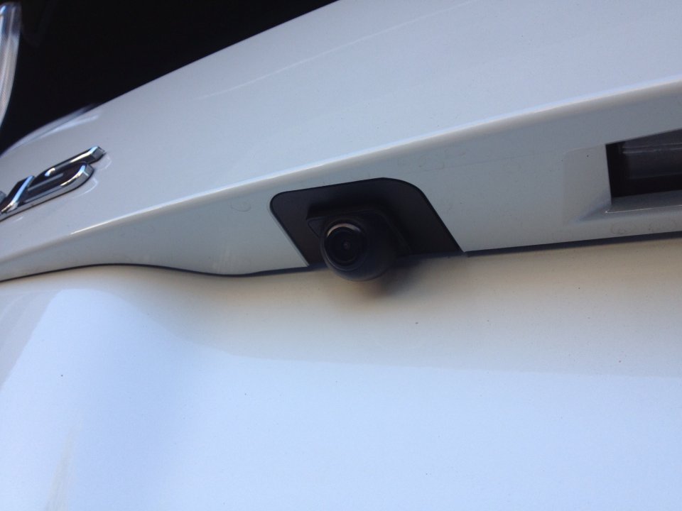

    2019 Prius Prime

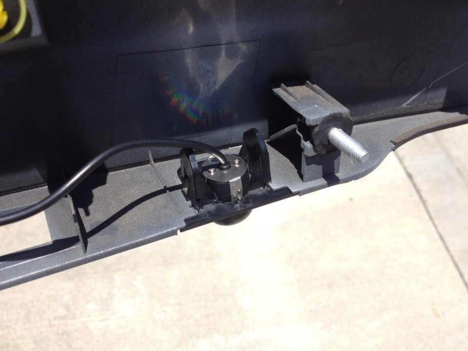

    I installed my backup camera today. The installation went ok, it just takes time to snake all of the wires into place. My $14 camera works great, excellent resolution, brightness, super small, and wide angle.
    Notes:

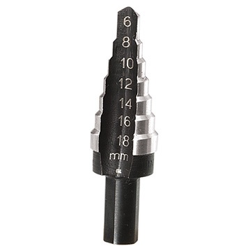

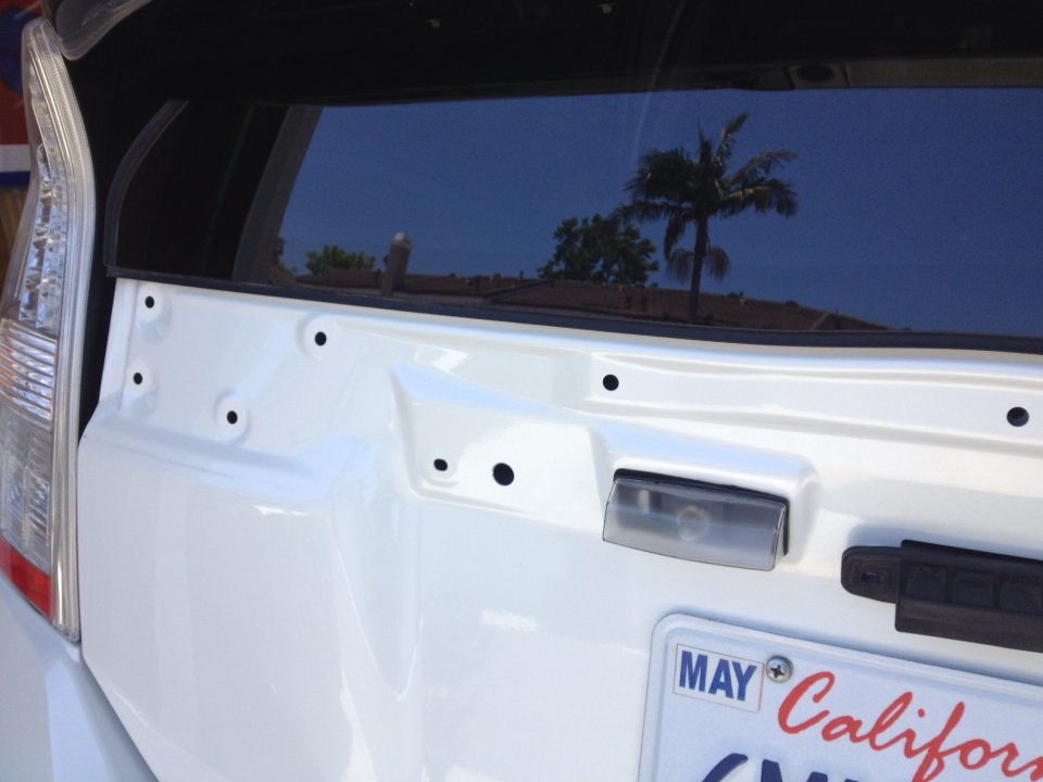

    1. I used a step-drill bit to drill a hole in the rear hatchback for the camera wires. The panel is aluminum so it's easy to drill. I lined the inner diameter of the hole with electrical tape to prevent wear on the wires, and sealed the hole with electrical tape to prevent any water getting inside the car (not likely due to the location anyway).
    2. Connections were simple: Blue "back" headunit wire to red camera wire and drivers side rear tail light reverse bulb wire. Black camera wire is left disconnected. Camera RCA plug to headunit RCA plug, you'll need an extension cable so pick up a 6' male/female RCA cable, or a female/female adapter and a 6' male/male RCA cable. And about 15' of speaker wire to get the blue wire back to the camera.
    3. In the previously posted installation video the guy struggled with the rubber seal below the rear window. He used a bunch of scotch tape, I found out a Qtip makes it easy to get the seal in the correct position, no tape needed.

  18. phoenixgreg
    phoenixgreg Senior member
    Apr 7, 2010
    1,157
    291
    66
    Phoenix
    Nice job! Looks very similar to what I did. I'm finding the backup camera to be especially helpful during parallel parking. The colored lines help me gauge just where the car behind me is so I leave enough room for me (or the other car) to leave.
