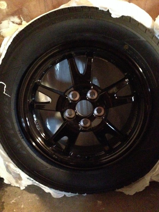

    I was pleasantly surprised to when I removed the wheel covers on my 2013 Prius. The wheel covers were covering some very cool looking split spoke gloss black wheels:)

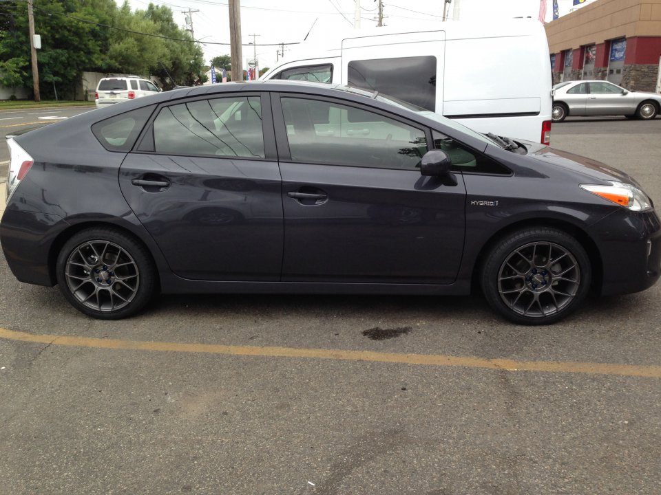

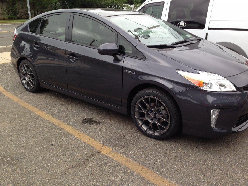

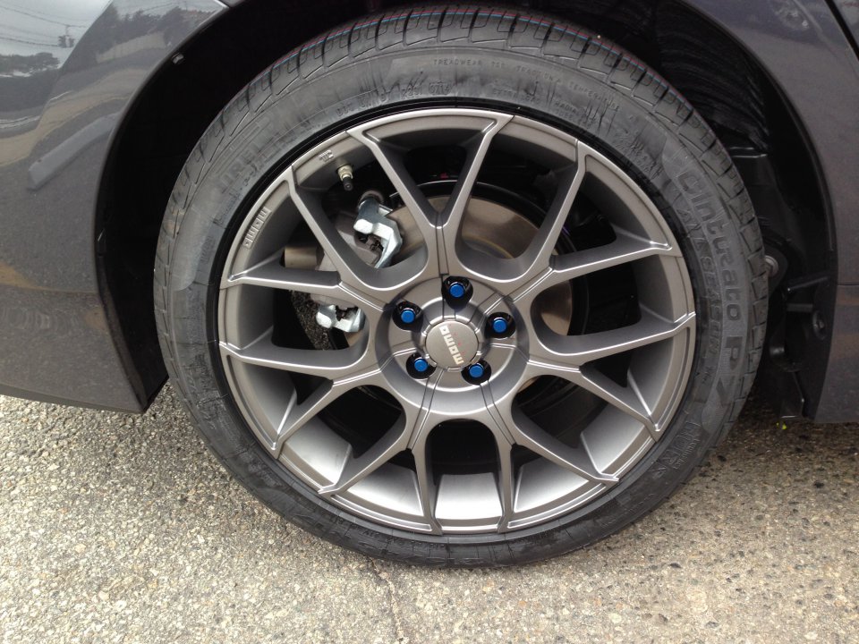

    Ok, so the wheels and tires are done...! Pictures are attached, and details are provided below.
    2014 Prius Four w/ Solar Moon Roof (Winter Gray Metallic)
    3M 50% Tint on all windows (except the little window on rear hatch)
    17 x 7.5" MOMO Raptor Wheels in Anthracite Gray
    215/45/17 Pirelli Cinturato P7 All Season Plus (low rolling resistance / enhances vehicle fuel economy)

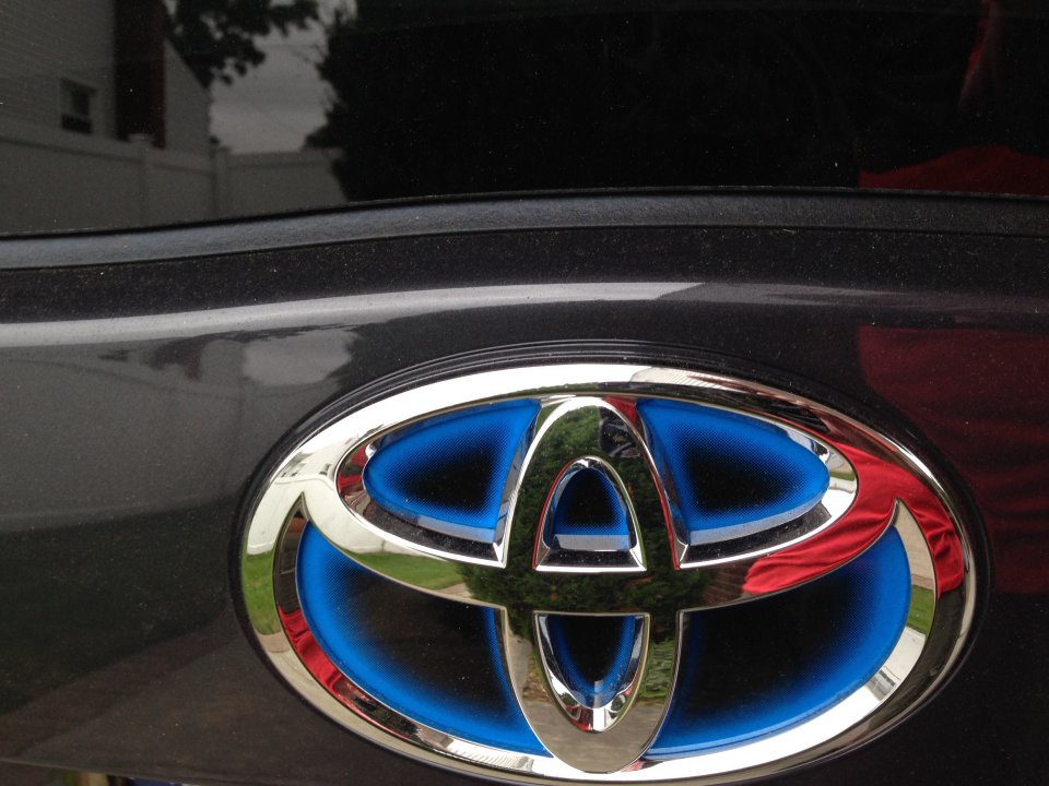

    McGard Spline Drive Blue Tip Lug Nuts P/N 65557BC (to compliment the hybrid blue Toyota logo)
    Noodleho, orenji, Farad247 and 3 others like this.

    Looks good, where did you get your lug nuts from??? Any issues with the bore being at 57??
  14. Gunjee
    Gunjee Junior Member
    Jul 2, 2014
    New York
    Farad, I bought the lug nuts off of eBay. It was an open box return item that was 50% cheaper than the kit on Amazon. Here is the link to McGard's website.
    SplineDrive Lug Nuts - Lug Nuts / Lug Bolts - Automotive - Products
    I'm not sure what you mean by the bore size being at 57...? The Prius bore size is 54.1mm, and the MOMOs bore size is 73.1mm. I bought hub centric rings from Amazon for $10 to marry the two...

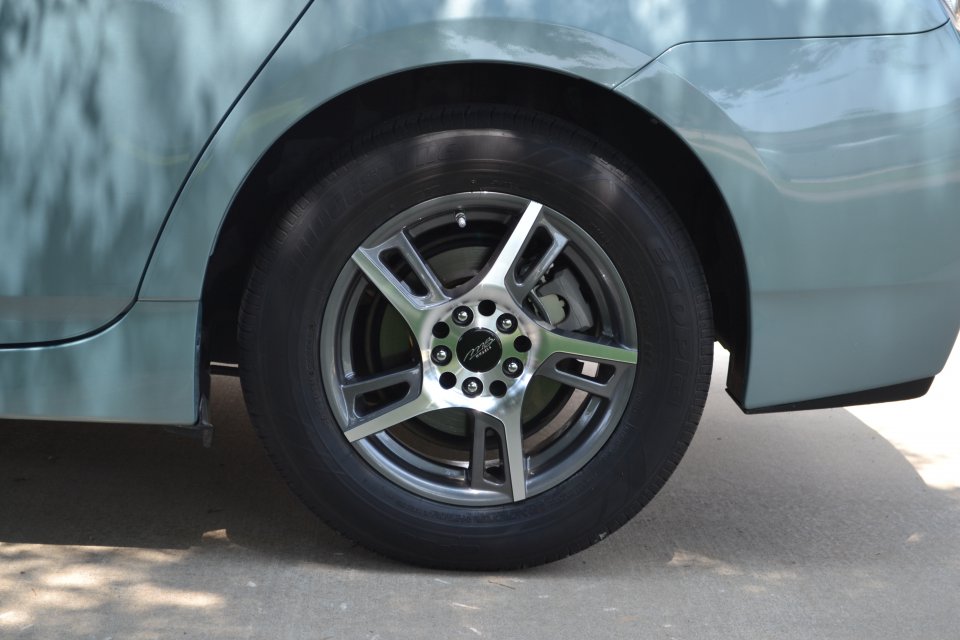

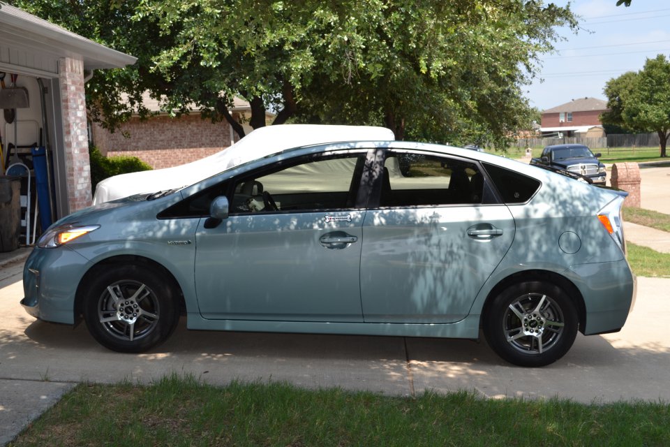

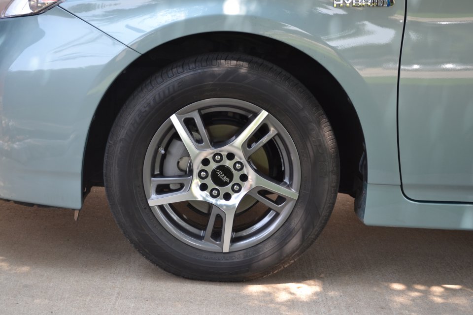

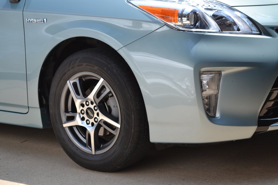

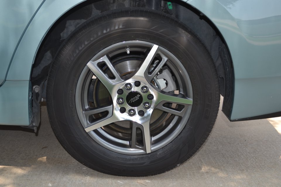

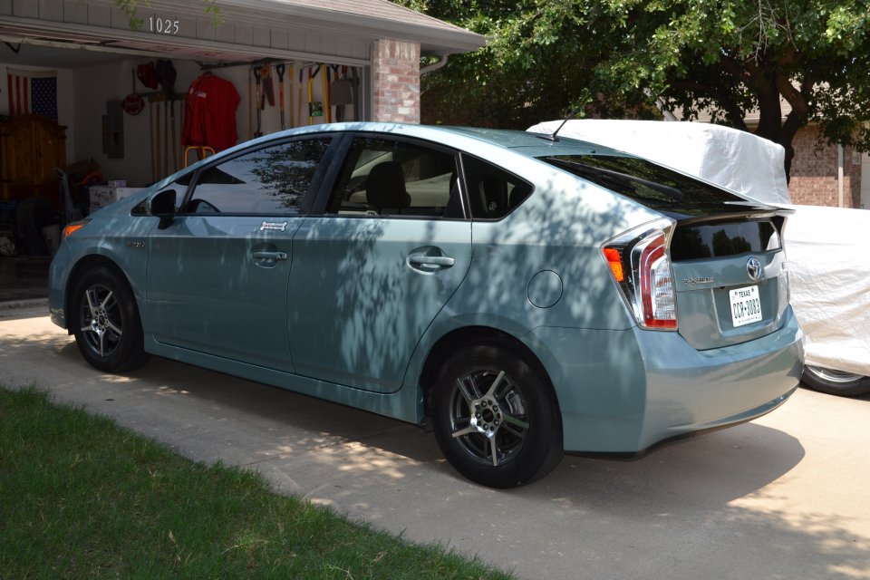

    For anyone who hates both the cheap looking plastic wheel covers and the underlying black painted alloy wheels...but do NOT want to go to a 16, 17, 18 inch taller & wider wheel with the required wider lower profile tires which will rob you of valuable miles per gallon of fuel....I submit the following option. I went with Discount Tires MB Wheels Vector 15" x 6" 38 mm offset wheels so that I could keep my original 195/65 x 15 tires. Please give me your opinions...have I done something interesting (good) here? DSC_1908.JPG DSC_1909.JPG DSC_1910.JPG DSC_1911.JPG DSC_1912.JPG DSC_1913.JPG DSC_1914.JPG

    Since you're asking for opinions, here's mine:
    Nice job trying something different, though I can't stand the "universal" aftermarket wheels that always have 5 extra lug holes. Do you know how their weight compares to the original rims? That's one of the main reasons for lost MPG with the 17's, so if your new rims are substantially heavier, you will still be losing MPG. Your new rims wouldn't be for me, but it's not my car, so if you're happy, that's all that matters!

    They are listed at 17 pounds. Not sure how that compares to original equipment wheel weight. I am sure someone on here knows that figure.

    jyoungprius - wheels look nice. The calipers / rotors stick out quite nicely. I'm not that much of a fan of the 65mm profile though, but that's just my opinion...
    With regards to the lost MPG, I haven't had the Prius for long, but I'm averaging 55 MPG on a 60 mile commute, with approximately 50 miles on highway and 10 miles through local streets. My 17" alloy wheels are 24 lbs. each. The 195/65/15 Yokohama tires that came with the car were low rolling resistance tires, which aids in the MPG savings. So I also went with Pirelli low rolling resistance tires for the larger wheels...

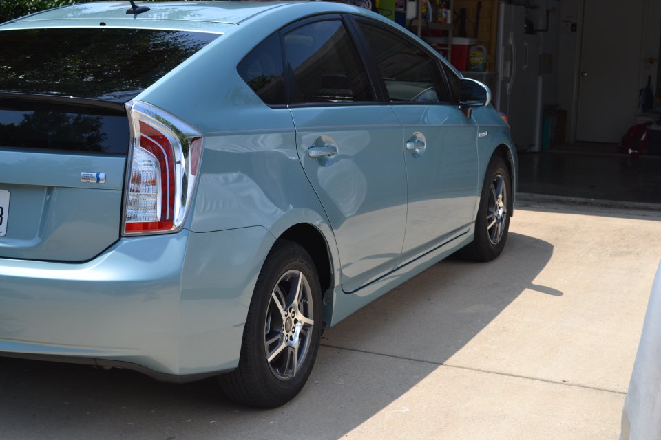

    If you go back to July 20, 2014 on this thread, you will see where I posted some photos of my '13 Prius with new MB Vector wheels. Well I decided I didn't really like them as much as I thought I would. I went back to Discount Tire & they special ordered a set of Milanni Kool Whip 446 - 5 spoke wheels & they did an even trade with no extra installation charges. The new wheels have more machine finish & black as compared to the anthracite (dark) gray of the MB Vectors. I and wife like these a lot better. Discount Tire has been more than fair with me for decades, and I highly recommend them. [​IMG] [​IMG] [​IMG] [​IMG] [​IMG] [​IMG] [​IMG]
