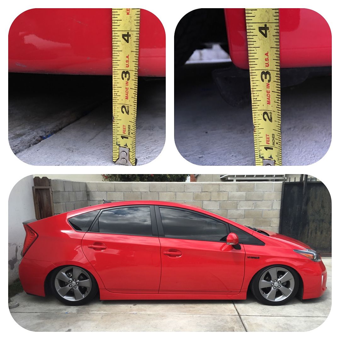

    I think I can go lower..but in the actual measurement..:the front is lower than the rear...
    pics front 2.81/ rear 3.00

    Mike. Measures from the side skirts. This will give u a more accurate measurement.

    The Side skirts aren't even....not sure how to compare the measurement of height off the ground I just measured the lowest points front and back...

    Last thing..after I remove the front 15mm spacers, I will get the struts more dialed in and the e level readjusted..then I will be able to go lower....
