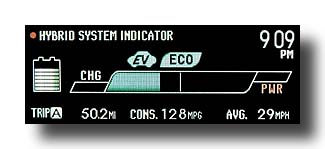

    I bought my prius a month ago. Still practicing some high MPG techniques.
    I notice something really interesting. I was driving in the city and i keep my speed under 30 mph. Sometimes even if i keep the energy indicator on the left side of medium line (which means all EV driving, exactly like the attached picture), the instantaneous MPG indicator will not always rise to highest, instead, it was about 40 or 50 mpg.
    Since it is all EV driving, i suppose the instantaneous MPG will be 100 MPG all the time. But it sometimes drop to 40 or 50 mpg on the instantaneous MPG indicator.

    Is the ICE fully warmed up and not running? If it is running to provide engine heat, cabin heat, catalyst heat, or traction battery recharge, you won't be getting 100 mpg.

    It turns out it is the heat. I was not aware of that... Thanks a lot for your reply.
  4. bisco
    115,358
    52,803
    you would have to wait until the ice shuts down, then reset the meter.

    I notice that when I reset the trip stats after the ICE preheats... I got 99.9 MPG as long as i maintain the all electric drive! Interesting.

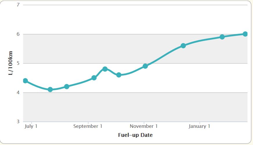

    The outside temperature and inside heating really hit the MPG. I could not do better than 6 L/100 km (39 mpg) during cold days this winter (below -20 Celcius).

  12. bisco
    115,358
    52,803
    it all depends on your trip distances. i was able to accomplish well over 40mpg on trips beyond 3 miles, even in the polar vortex.

    Roger T, remember that the Prius has to get into the fully warmed up situation before it will show 99.9 in EV mode. This is commonly referred to as S4 mode.
    Once you get into the S4 mode, the Prius will then show the 99.9 whenever you are not using the ICE.
    This is explained in detail in the following link. Even though the data is for the older generations, (Gen I and Gen II), it still basically works the same way in Gen III.
