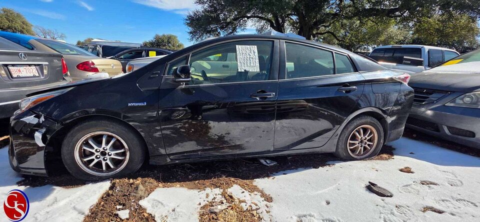

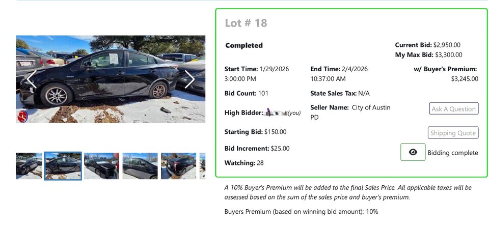

    I bought a 2016 off an auction, locked, no keys, dead battery as is where is.

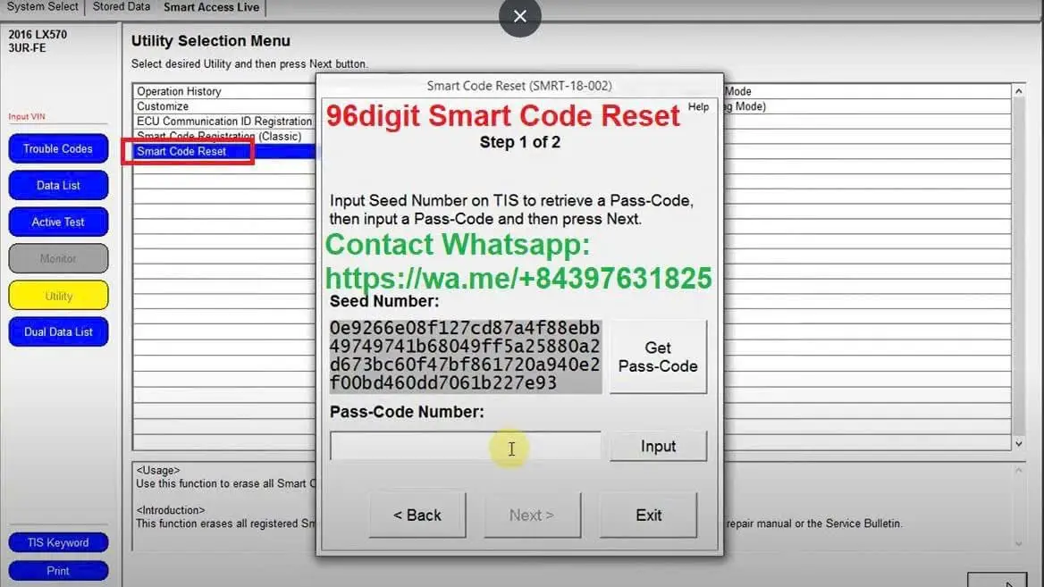

    The passcode calculator I used to get the seeds wouldn't support 18. I paid 30 dollars for 5 seeds. The site allowed you to retry with the same vin with the same key code multiple attempts. make sure the provider you use allows you to do this retry as it took me probably 7 attempts till I got a version of techstream that would work.
    I located a copy of version 17.10 and thought i was good to go. I could not make it work. It would start, give the seed, you put in the response code and it would fail. Tried this like 4 times, resetting car, laptop, techstream, imagine chicken dance, no joy.
    My version 10.10.18 that i used with vci would only allow you to choose up to 2015. I saw that 10.10.29 worked on a 2016? If anyone would like to donate a copy to my cause please message me a link, it would be appreciated :).
    I selected 2015 and went through the lost keys process with version 10, took 16 minutes. After it completed you program the primary key fob. After you program the primary keyfob then you have to use the primary key fob to add additional fobs up to 6 I believe, maybe 5.

    the seed code picture is just something I found surfing but it shows where you go in techstream and what it looks like. The other pics are the auction car, cause no pics it never happened right?

    sorry for the delay I didnt get notification of your message.
    Lexus, Scion, Toyota PASSCode Calculator / Generator: Calculate Pass-code by Seed number | Immobilizer Pincode Calculator
    this is the seed provider I used. One of the challenges is to be able to keep the techstream off the network but keep the laptop on so you can copy paste the numbers to the calculator site. I used a laptop that was running vmware workstation that the clip board would work from inside the virtual to the host. I dont have a vci cable recommendation as I have two that i bought off amazon for 20 bucks each 5 years ago.
