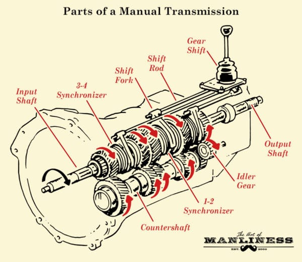

    If you want to impress me with one of these 'simple' 48V systems, do the following:
    Put the motor on the "Idler Gear" with computer control of the shift forks and clutch and eliminate the 12V starter. It won't matter if the car has 12V, 48V, or 336V primary power. For higher voltages, use a DC-to-DC converter for the 12V loads and as voltage appropriate (and affordable) accessories show up ... the path is obvious. Actually there is an ideal voltage for North America:
    • 120VAC -> +/- 168V peak-to-ground, two battery packs
    • 2 * +/- 168V -> 336 V peak-to-peak
    Using the power electronics, we could plug the car into the grid for a 15-20A, 120VAC circuit.

    Well what you are asking is pretty close to the P2 design attached to a double clutch transmission. Of course a double clutch transmission is more expensive than a manual, but much faster shifting and more efficient when programmed to be ;-) P2 can also be attached to a traditional automatic, with or without a locking slush box. P2 does require a designed in approach, versus the P0 mild hybrids or start stop gms that we are all familiar with. IMHO a P2 approach with a hybrid turbo 4 and advanced cylinder deactivation, could give vastly improved efficiency over a 6 cylinder for 240+ hp applications. In order to get real efficiency gains on 200 hp and lower (208 in the new camry hybrid) psd type hybrids seem like a much better trade off.
    Voltage matters, because engine off operation require higher power. This can be done with lower priced wiring and components at 48VDC versus 12VDC. Yes the 48VDC systems all have dc to dc converters for the 12V, JCI is proposing the converter and two batteries in a single battery component with both 48V and 12V terminals for micro-hybrids. Obviously higher than 48V is better for bigger mg's, but regulations require extra safety equipment above 60V, and 48V is a compromise.
