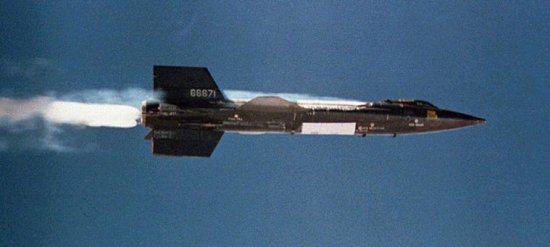

    In this case, the ammonia is used to neutralize/regenerate the NOx SCR, not as a primary fuel. But I was trying to point out how practical anhydrous ammonia is due to the lower pressures and easily handled infrastructure. If I were challenged to do a cross-country, fuel cell trip, it would be using anhydrous ammonia with a converter because it is so common in farming.
    Now if I wanted to do part of it at 4,000 mph:

    let me know when you get certified to fly the x15's launch platform . . .
    and then there's the maintenance costs .... probably cuts into efficiency
