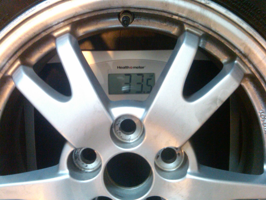

    Alright guys, I was able to get the wheel on the scale a few mins ago. I didn't dismount the tire so I don't have the true weight of the rim alone but I also weighed the stock 15s so you can get an idea of the difference in weight.
    Stock Toyota 15x6 +45mm with Yoko Avid S33 LRR 195/65/15- 33.5 lbs +/- 0.5 lbs

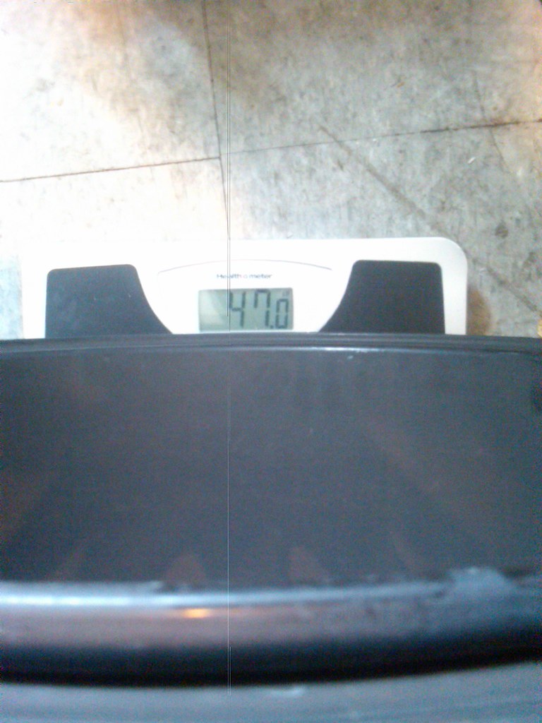

    XXR 522 18x9.5 +38 with Falken ZE912 225/40/18 - 47.0 lbs +/- 0.5 lbs

    Summary:
    ~13.5 lbs increase in wheel/tire combo weight per wheel. That's a ~40.3% increase in weight per wheel.
    How much does that effect performance? Well its a 2:1 ratio of static weight vs rotational so I gained ~27lbs static weight feel or equivalent of 108lbs extra. I lost ~5mpg (48.x to 43.x) but tracking felt much more stable and turn ins much sturdier. Where I feel the most impact though is in the acceleration and braking (which is expected for such a heaving wheel).
    All in all, I think its well worth the hit for how much better the car looks. I def get more thumbs up now that I have such an aggressive stance and I'm sure there will much more respect given once I get my car sitting proper.
    Anyways, I hope that helps you guys who are looking at wheels. Just remember that the ones I have are pretty wide as well so if you're going for something in the 7.5-8" width, it will be a good bit lighter.

    **Yikes those suckers are heavy!!** It probably feels more stable cause you're driving with boulders man. :) Just messing with ya, Andy. In your case, it's style over function.

    I dug up my old thread on swapping back and forth between my stock wheels and my 17s and I see my stock 15s on the GenII were 31.5lbs. My 17s with the Kumho Ecsta ASX were 37.6-38.2lbs..
    Your setup is HEAVY BRU! haha
