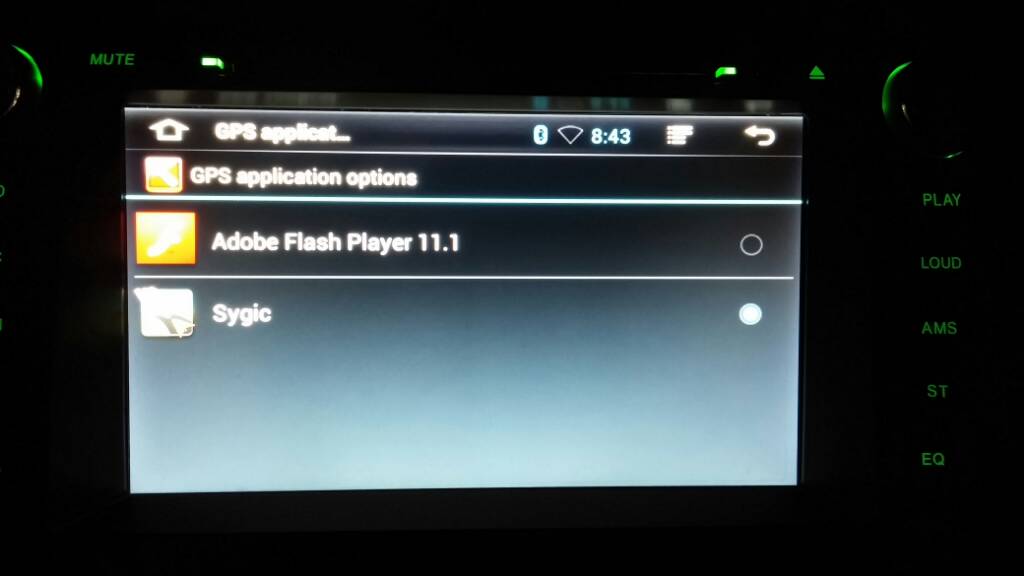

    Great, I bought both items and will try again at this next week. Now that you've helped me grasp this I feel much better! A few other questions
    1. The OP said the backup camera was grainy, I am not sure it is worth the challenge to install or not. What was your experience?
    2. What did you end up using for maps? I tried to Waze but Google Apps said it wasn't compatibility. I installed the app that came on the SD but it was in Chinese. Lastly, anytime I select the GPS icon on the home screen I get a message that there isn't an app. What was your experience?
  8. chickenhawk
    chickenhawk Member
    Sep 13, 2011
    261
    95
    CA
    You guys need select the sygic as gps app.under settings[​IMG]

    1. Same as OP. Only grainy at night. Not bad in day time.
    2. I use Waze only. You can download the apk from somewhere else instead of google playstore. Not sure about the GPS icon problem. My unit came preloaded with Sygic and it's not in Chinese.
  11. chickenhawk
    chickenhawk Member
    Sep 13, 2011
    261
    95
    CA
    Yes it comes preloaded but it wont work on main screen until you set it in settings. They say its grainy cause small sensor and nature of ccd even though its the nature of the beast
