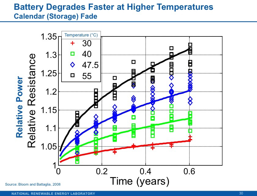

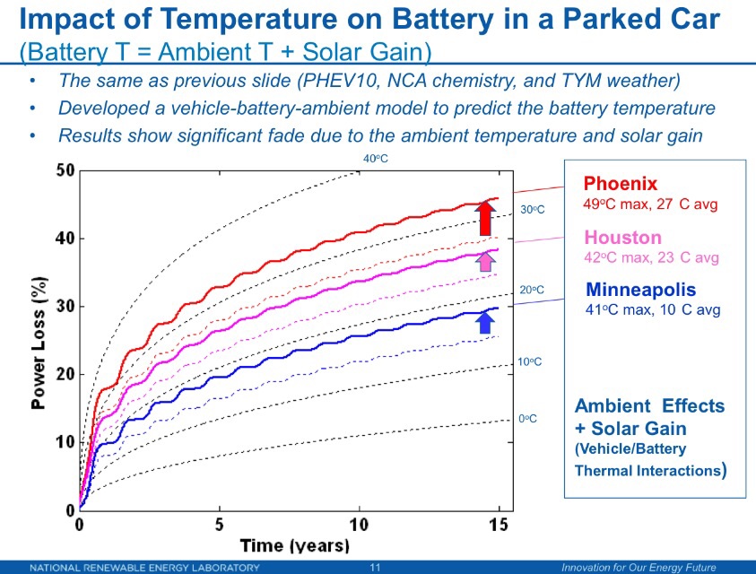

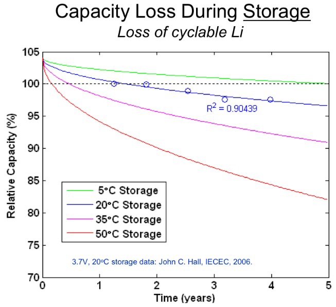

    Battery aging can be characterized in different ways including loss in energy capacity (EV range) and ability to output power.
    I have seen a nice table of capacity loss by temperature and SOC which might take a day or two to go find from a book I have.
    At least a couple of studies I have read specifically point out the solar load in the Prius from having the battery case right under the large and nearly horizontal hatchback window. By contrast, the Volt battery is mounted within a deep steel tunnel running under the car and added insulation protects it from cabin temperatures due to solar exposure.
    These graph temperatures are in Celsius so:
    20C = 68F and every additional 5C is an added 9F
    25C = 77F
    30C = 86F
    35C = 95F
    40C = 104F

    As far as I can see, the only actual data points in there are the circles on the 20 degree line on the last slide. Exactly what the storage pattern they are recording is is unclear (permanently charged? To 100%?). Taking them at face value, though, there is good and bad news. The bad news is that the nil degradation we are reporting does not mean we won't start to get some in the next few years. The good news is that, even if the model is right, on John's actual temps, battery degradation is only 10% after five years, and on a shallow trajectory.

    I believe the reference to 3.7v on that slide implies that the cells are being stored at about 50% SOC. The graph shows projected data based on a mathematical model and the circles show actual empirical test data proving the model.
    The real overall takeaway here is that temperatures in the range of 70F vs 95F actually do have a significant impact on battery aging.
    It's worth it to park in the shade when possible (especially with a full battery). Charging right before use, when possible, is good because may allow a cool down period from a previous drive and it minimizes the time that the car is sitting around with a full battery.

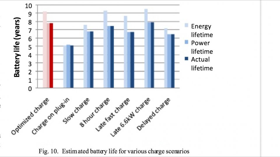

    Here's a chart showing different strategies for how and when to recharge in order to minimize battery degradation. The "late 6.6 kW charge" (2.3 kW for PiP) is about the best strategy and the worst is to just plug in and immediately charge because it leaves the battery with a high SOC for the longest period of time.

    I always park facing the sun, having the front windshield taking the brunt of the shine. I also always leave the shade in the cargo area extended to fully cover the hatch area. I leave the Prius in the shade until right before plugging in too. The sun here in Minnesota is less direct than in Arizona as well. So basically, solar exposure in back can be minimized... a point often not taken into account.
    Yesterday's data collection was an intentional act of leaving the Prius out in the sun and parking with the hatch facing the sun, though the cargo shade was extended. The high temperature during recharging was only 35°C (95°F), a value low on the charts provided. How many owners will recharge during the hottest time of the day anyway?
    And I do take issue with those charts. That supposed "significant impact" glosses over the fact that temperatures are not hot year-round. In fact, here, we only see the potential for temperatures above 25°C (77°F) just 4 months out of the year. That means the battery stays very comfortable for the other 8 months.
    There's also the fact of SOC level not being addressed. Those charts, from 2006 & 2008, don't make any mention of that. Back then, 100% capacity was the norm. The battery was always recharged entirely. That was years ago. We've learned since then that avoiding 100% is a good practice for battery longevity. Prius stops at 85% for that very reason.

    I would like to study the source of this graph in post #117. It shows battery "actual lifetime" less than the warranty (CARB state NY) if you use optimal technique or not. I would think that we would have heard the owner outcry if the graph was accurate.
