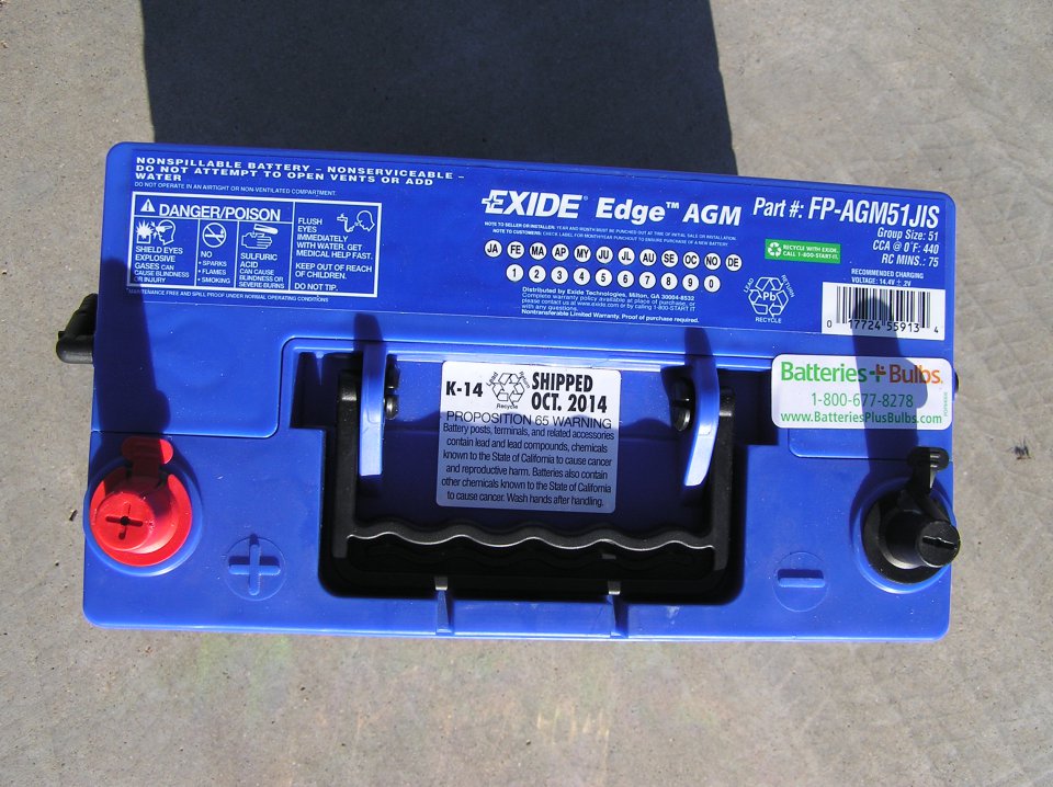

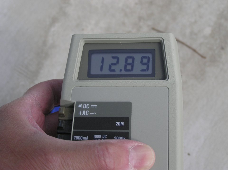

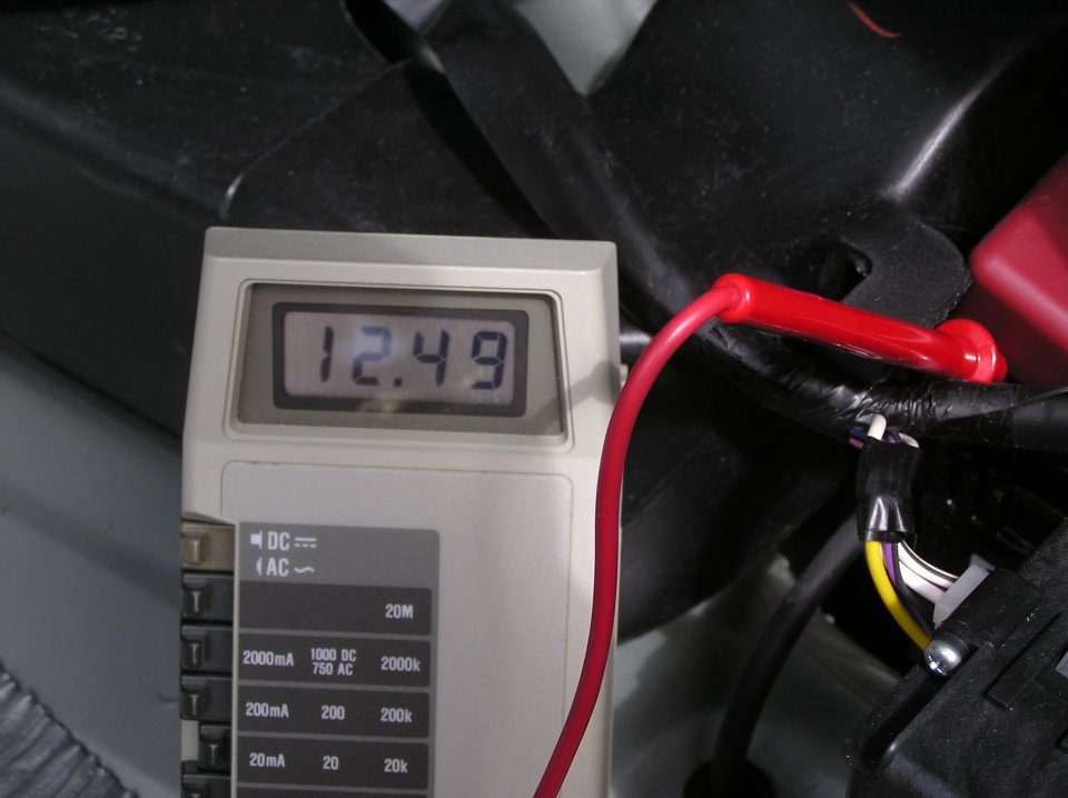

    I installed the new Exide battery today, and the voltage was 12.9V after more than two days of rest. The old GS Yuasa battery will be four years old in July. It measured 12.5V so it did not need to be changed at this moment. I'll take it home and charge it up and see how it does.
    The only problem with this Exide Edge AGM battery is that the vent hole is too small to fit the black hard plastic vent fitting. If I had my electric drill available, I would try enlarging the vent hole. I'll contact the battery store when I get home to see if the correct fitting is available for the Exide battery vent hole.
    Attached are a few more photos to document what the vent hole looks like, the voltage of the old battery as of this morning, and the new battery's no-load voltage after charging and being at rest for 2+ days.

    Thanks for the information Patrick, all useful. The vent hole looks to be the same size as the hole on the mobility batteries I fitted. I use a screen wash hose joiner to push into the battery and the hose fitted on that well. No need for an elbow. A short piece of screen wash hose also works well.

    BTW, measuring 12V battery voltage while car at rest with a simple voltmeter doesn't tell you too much about battery state of health.
    Test the battery with a load tester and/or internal resistance meter on a cold morning before you turn on the car. This procedure is way more useful.

    I agree that measuring battery voltage will provide an indication of SOC but says nothing about Ah capacity. Need to use a load (like headlights) and measure drop in battery voltage to get a subjective indication about the latter.

    According to the below, the Exide was supposed to come with an elbow. Perhaps if you call Exide, they will send you the missing elbow?
    12 volt battery for 2009 Toyota Prius | PriusChat

    The one you got was supposed to have one taped to it on the side per the below. I wish they found a way to embed the elbow into the top cover (just like how the handle embeds into the top cover) so it's not lost easily for those that need it ...

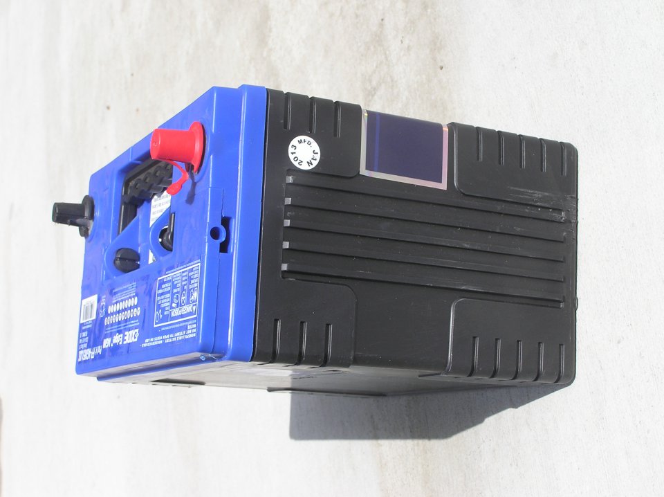

    The Exide battery that I bought in May 2013 (post #5 above) is now dead. The symptom that I noticed while driving the 2007 is that the overhead cabin lighting brightened substantially when the car was made READY. It was obvious that the voltage produced by the battery was way under 13.8V.
    I tried charging the battery and found that the charging current would not diminish over time, and that the voltage produced by the battery was only ~11V. Hence it was clear that a cell was shorted. I returned it to the retailer, they confirmed the battery would not hold a charge, and I got a new Exide battery manufactured in July 2014. I even got the correct vent elbow which fits that battery! The store had partially charged the battery and I am now finishing that job.
    In the meantime I reinstalled a 2009 vintage GS Yuasa battery that I had taken out of the car when I put the Exide in. I've kept the GS Yuasa in the garage, charged it every 2-3 months, and it has aged very gracefully. At a charging voltage of 14.4V, the current flow declines as the battery charge increases, and the final current flow is only ~0.04A which is like a new battery. Typically as a battery ages and loses capacity, the final current flow will be much greater, 0.2A or more.

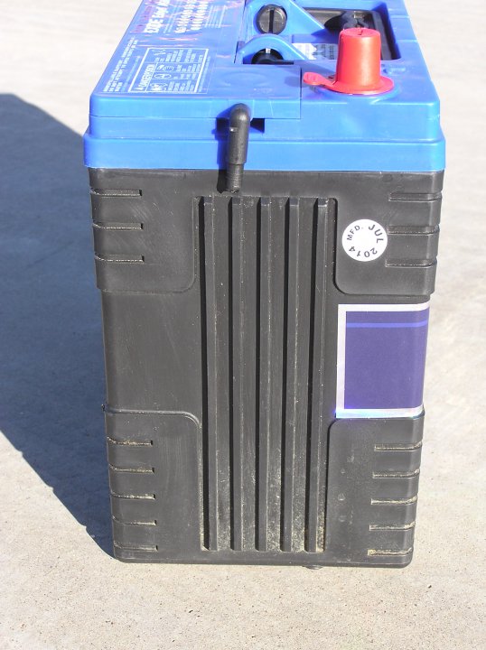

    I've attached a couple of photos which show the new battery's stickers and the correct vent elbow.

    One thing I wish was better with the Exide battery I tried is that the plug for the vent hole on the other side doesn't seem snug or make a good fit. One might have to use some glue to make sure it doesn't fall off, especially when there's any kind of pressure in the vent system.
    I am curious to learn if the new battery you got suffers from the same issue.

    No, both the plug and the vent elbow both seem to fit well. I suppose you could use a super-glue to hold the vent plug in place.
